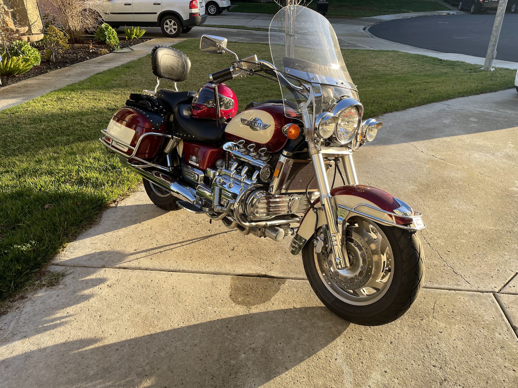

Gentlemen
I'm writing to report an issue that happened with the rescue Tourer (http://www.valkyrieforum.com/bbs/index.php/topic,125764.0.html).
I've last rode it to Sacramento (a nice 130 miles roundtrip) in late November, so near 2 months ago.
Since then the bike has being resting in my garage while we wait for better weather. I've added Stabil Marine to the empty gas tank and topped it off before letting the bike sleep for the winter.
Thursday we had a break on the rain and I decided to take the old girl for a ride. The bike had some trouble to start (it was left in a trickle charger and the battery is new) and I left her idling and warming up while I got my motorcycle gear (around 5 minutes I think).
When I returned, I found a puddle under the bike with what looks like gas.
I was able to record a video and found dripping coming from the carb bank area:
https://photos.app.goo.gl/F5WxmiX6KYqBvmBm7
It seems to be leaking from both sides (right and left).
I did some research and apparently there are a few possible reasons for these leaks:
a) Stuck floats.
b) Stuck float bowl needle.
c) Fuel rail o-rings.
d) Maybe petcock issues.
I left the bike seat and started it again around 24hs later but it is still leaking.
My first question is for people who had leaky fuel rail o-rings: after how many days did it fix itself?
I imagine if it is still leaking after 3 days, it is probably something else from the list above (a to d).
I'm also considering what are my options here. I already spent near $6K in this bike and having to rebuild its carbs would add even more on top of what I've spent already.
I noticed that there is a vendor associated with the VRCC that offers the service for rebuilding the carbs (https://valkyriecarbsandcustom.com/ols/products/your-carbs-rebuilt). Anyone has used them and could report if it went smoothly?
It had its carburators supposedly rebuilt back in 2021 by a Honda dealer, but let's be honest... I wouldn't be surprised if they botched the job.
I have to admit that I feel a bit disappointed with this Tourer bike. I think I managed to put less than 200 miles on it so far.
 Undecided
On the other hand, I went and tried to start my old I/S and it started on the first try. No leaks. Idling smoothly. Carbs to the best of my knowledge were never rebuilt since it left the Honda factory in Marysville, about 25 years ago. I know who is the keeper now.
A photo of the bike, notice the gas puddle:
« Last Edit: January 27, 2024, 12:15:13 PM by Savago » Logged

tighten the end nuts of the threaded rods that hold the carbs together. use wooden dowel to lightly tap them together, then tighten, and repeat. usually only takes 32nd to eight turn on nuts and usually makes that metal crack noise.
I've had to do it twice in 82k miles, never leaks after that procedure.
