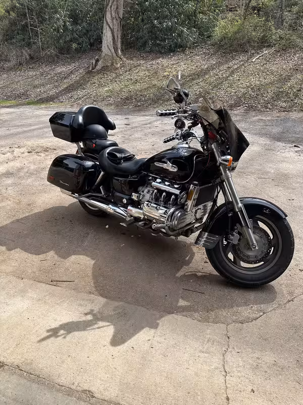

Hello from Western North Carolina. Finally after 20 years I have a Valkyrie. It is in need of a deep cleaning but runs great. I have concerns that the maintenance on this bike has been ignored. It is a 2000 CT I believe. The previous owner had some after market trunk on it that interfered with the saddlebags opening so he just scratched them up pulling them around the trunk. I am replacing all fluids and filters along with the brake pads and tires (CT on the back) Bike has 50k miles.
Is there anything that I should be checking? I don't have a service manual yet. Is there anywhere that I can find a passenger backrest?
I have been looking around the forum and it seems like a great community of riders. are there any Valk owners in Western North Carolina on here.

« Reply #29 on: April 09, 2024, 06:42:36 AM »
This is what I started with
Do what you were made to do. If you don't know what that is, find out. We all have that one thing.
2000 Honda Valkyrie CT.
2012 Harley Ultra Limited

« Reply #30 on: April 14, 2024, 12:45:07 PM »
Here is an update. Went to town a couple times by myself and the bike ran great. With that BatWing fairing on it there is a whistle coming from somewhere that starts about 40 mph. My bride says it looks cheep and to replace it with a windshield, Smiley. I got a backrest from a hand on the forum and got that on so I could take her for a ride and she loves it. 205/60/16 is a bit to big for two folks of our girth so the tire rubbed on the right side. I will pick up a 195 tommarow.
I am so impressed with this bike. is there a fuel gage available for it anywhere?
I will ride it this season and see what to do with it this winter, Floorboards front and back, lights and the like.

« Reply #32 on: April 14, 2024, 01:32:53 PM »
u need to do the fender nut mod so tire doesn't rub. I run a 205/65-16 lowers rpms by 200 for better mpg and it doesn't rub.  remember to adjust shocks to level 5 when riding 2 up.
Posts: 30830
« Reply #33 on: April 14, 2024, 07:41:01 PM »
Here is the old link to the fender washer mod.  http://www.s2s-accessories.com/photo/fndrmod/
I also seem to recall some cut the nut cages off to gain more clearance.
Worth trying before buying another tire.

« Reply #36 on: April 17, 2024, 05:52:01 PM »
Well I already ordered another tire. I wasn't comfortable riding on the one that scrubbed, but thanks for the information. I will see how far I can go one a tank. I read somewhere that it was only 110 miles.
Thanks of rthe input everyone.
