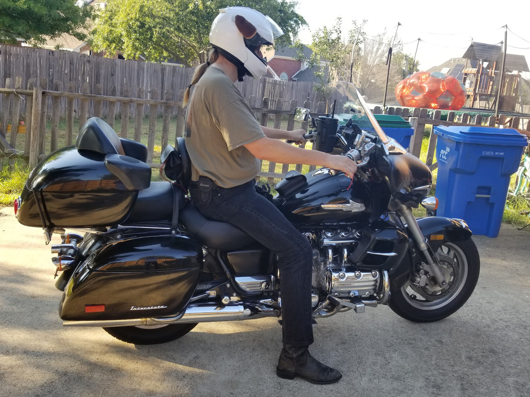

Found an old thread where this topic was discussed... Me on my Interstate on stock seat:
And me sitting on the Interstate with the Hartco Custom in place:
And the thread in its entirety:
https://www.valkyrieforum.com/bbs/index.php/topic,102443.0.html

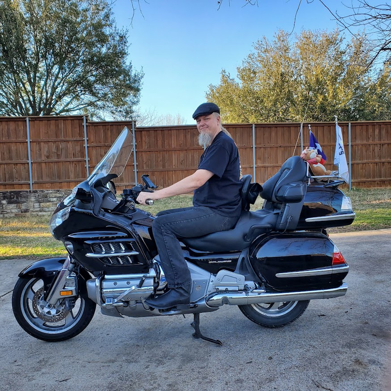

One more comparison. Obviously not a 1:1 comparison but, me on my GL1800 with stock seat:
And with the Hartco custom:
Posts: 30944
« Reply #13 on: June 04, 2025, 06:05:37 AM »
On the Wing with stock seat, your knees are almost right on the fairing.
On the Hartco, it looks like you gained at least 4" of space.  Passenger space got smaller, but the hell with passengers, I take none ever anymore.
