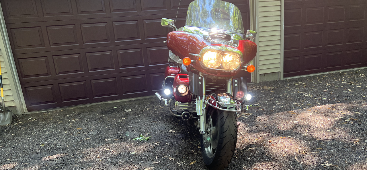

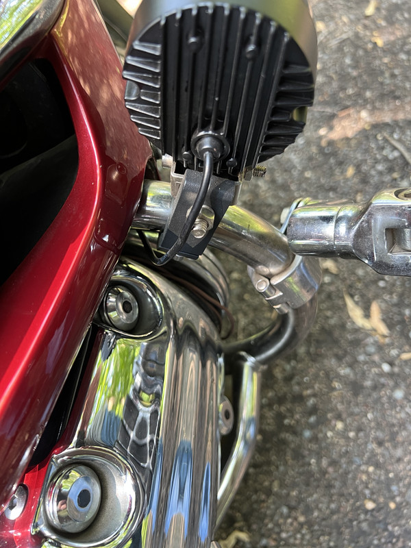

You are unlikely to ever find pod lights for an interstate except maybe used on ebay.  On top of that, cutting those old brittle pods for a light install is risky business and you may ruin them easily.
I would not waste my time.
Do some measuring and get some small aftermarket and mount where you want them.
One of my interstates came with small Motolights  (30 watt) on front brake caliper mounts (to be seen, not to see), and small bright PIAAS (70 watt, to see) up on the fork wings below the fairing.  I never run them at all (unless I blow a faring light)(and I never ride at night anymore).  Both are wired to a switchbox mounted on top one of the hydraulic reservoirs on the handlebars.
Motolights, caliper mount.
PIAAs
