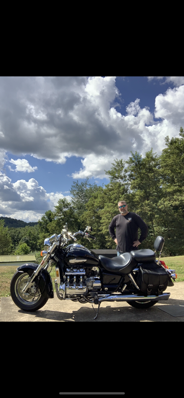

Hello everyone, new member here with many questions.  I recently bought a 2003 Valkyrie and am having very minor gas leak from middle carb on right side…is this #3.  Also have some hoses that are cut.  I know very little about DIY bike repair and hope to start a dialogue here.  Will post some pics as soon as I figure out how.

If you post where you live, maybe someone local can come take a look. BTW: you have a nice mechanic helper.
Sixgunluvr
Posts: 14
« Reply #2 on: August 17, 2025, 09:41:44 PM »
She’s more of an ornament than a helper.  Cheesy. Still working on pics.  Here is one of the hose missing.
