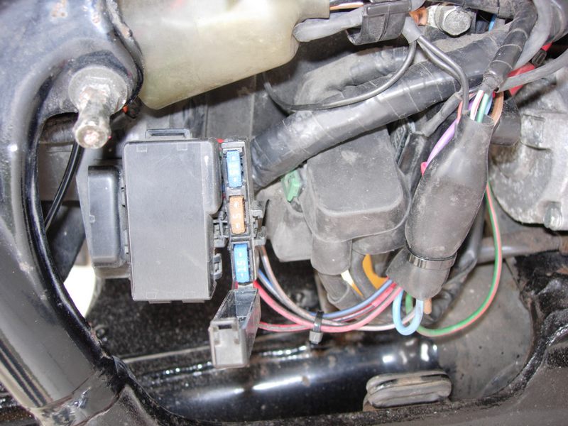

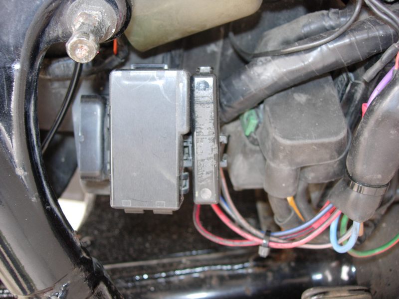

I asked a question recently about adding an auxiliary fuse box for the various bits and pieces that I intend to add. After considering what I wanted to do I realized that I only actually needed two fuses one permanently live and the second switched live. I went to a motorcycle breakers yard whilst I was in the UK and I found a small two mini blade type fuse box on an off-road bike that I thought would do. When I actually came to fit it today I found that it had a dovetail groove on the side and this matched the dovetail on the stock fuse box. I slotted the two together and did the wiring.
This is what it looks like fitted alongside the original
So if you only need a couple of fuses this may be the way to go.

« Reply #1 on: March 02, 2010, 07:44:15 AM »
That is a lucky find. Worked nice hooking together. Did you get a model and size of the dirt bike so we can search part numbers ?  Smiley

« Reply #2 on: March 02, 2010, 07:52:52 AM »
Nice Job  cooldude

« Reply #3 on: March 02, 2010, 09:02:23 AM »
looks like they could be daisy-chained together too.  very nice. looks stock.

« Reply #4 on: March 02, 2010, 09:22:41 AM »
No sorry I didn't.  Embarrassed The breakers just had a load of looms (unmarked) I told them I wanted a small sized one and they just cut it off gave it to me for $2 (£1.50) Smiley and the guy said he thought it came from a 125cc trials bike. There isn't a part number on it so I can't assist any further.

« Reply #5 on: March 02, 2010, 10:24:10 AM »
That is about as clean as I've ever seen. Very nicely done.  cooldude
