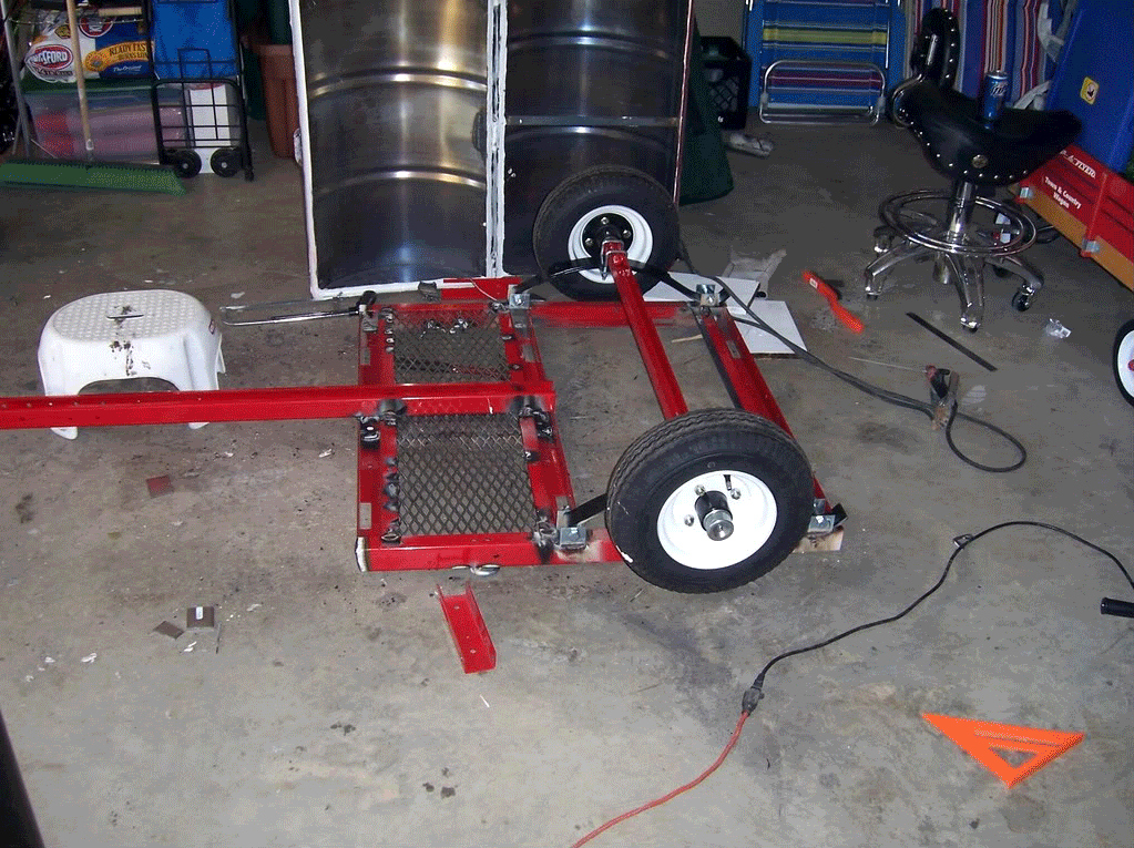

Looking to trailer some things behind the bike and was considering "building" one of my own as I wasn't happy with the sizes I was finding and the prices were very high (in my opinion).  Does anyone have a good source for trailer parts and accessories?

Hey G I built mine a couple of years ago.Got the trailer from Habour Freight. Have about 500 into it including hitch and converter .Picked up a used topper and hitch to keep the costs down. Pulls great but you always know it's behind you. Got a ton of info from this site http://forums.delphiforums.com/MCTrailertowing/start

Even "blinged" out with the diamond plate and chrome, I was still in for less than a grand. For a simple setup, you can do it for about $300 if you shop (not including a hitch).
Craigslist can be your friend, especially for a car-top cargo carrier. I see them semi-local for $50 all the time.
The whole story of my build is here: http://www.valkyrieguy.com/mctrailer.htm
I just sold the Harbor Freight one above last Friday to another VRCCer.

I bought a trailer kit from northern tool on sale for $150. I grabbed some mild weld steel from tractor supplys scrap metal bin to build my hitch. I think it was $15. You can go to a steel supply and get the stuff for 1/2 that cost. I bought the 1" reciever tube for $20 at tractor supply. The tool box was $179 (i think). The expandable metal was $25 at a local trailer store. I bought some heavy duty hooks from tractor supply also. I think they were $10. I have about $400 in the whole thing including hitch. I know it's not the best looking thing going down the road but it serves the purpose. I have at least 15,000 miles on it and hauled over 200 pounds with it a couple times. No problems.

Harbor Freight frame, narrowed 4 inches, tongue added 14 inches to length, with a used Sears car topper, less than $500 in it, with a rattle can paint job to match the bike.

Did you upgrade the tires?  The Harbor Freight ad I saw indicated that the maximum speed for the trailer is 55mph.  I would assume that is a tire/bearing limit.

Hey Joe. Those chrome rims and tyres come from Habour Freight but only online when I got them and are now disco. Yes ,I saw the 55 limit on them but the trailer was rated for over 1,000 lbs and I am lucky to have 200 on it.May have something to also do with COA (Covering Ones Ass) and other legal stuff.
I have had the trailer over 90 MPH and no problems. I even checked the rims to see if they were heating up. No heat at all. I did re pack the bearings with good grease after I built it.
 Over all,very happy . I built this as a "Starter" unit to see if I liked trailering  but it has worked out so well, its a keeper now. I hope I haven't upset any of the "Anti-trailer" folks here.
