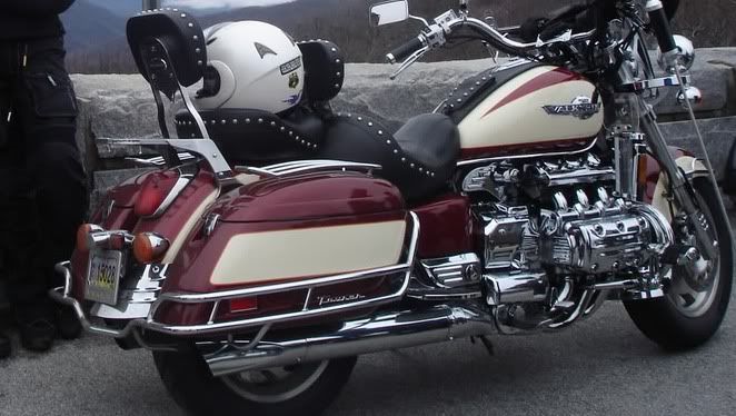

I asked that question about the Honda bag rails here a couple weeks ago.  Smokin' Joe says they fit the Champion bags and provided this picture as proof.......
I assumed they'll fit, but in the pic, the bags rails don't look level and look as though they're slightly angled down towards the rear.  Maybe it's just me or the angle the photo was taken.....don't know.
But then again, there was an ad in the VRCC classifieds a week or two back.  In it, someone had a set of Honda bag rails that they were selling.  They said that the reason they were selling them was that they had the Champion hard bags on their bike and the Honda rails wouldn't fit.
So, the debate continues I suppose.

« Reply #6 on: March 25, 2010, 04:49:11 PM »
They will fit. That is a picture of my buddy bike. He lives around Hattiesburg and still rides the bike. He is coming over next weekend and we are rebuilding his forks and installing steering bearing. If you need any info let me know and I can see how they are mounted.

« Reply #9 on: March 25, 2010, 06:40:34 PM »
BF, you obviously didn't look at the pics I posted showing the bottom and back of those bags and the Hondaline bag rails. Here's the link http://www.valkyrieforum.com/bbs/index.php/topic,13809.0.html.  Got look at the last post.
Marty
« Reply #10 on: March 25, 2010, 07:36:53 PM »
No, I guess I didn't.  Don't remember seeing those.  Thanks.  From those pics, it looks like they'll bolt right up.
However, to clarify, are they a direct bolt-on/fit?  Or, is there some degree of massaging to do get 'em to fit/work?
