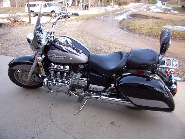

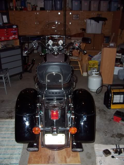

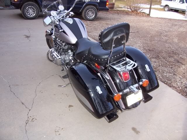

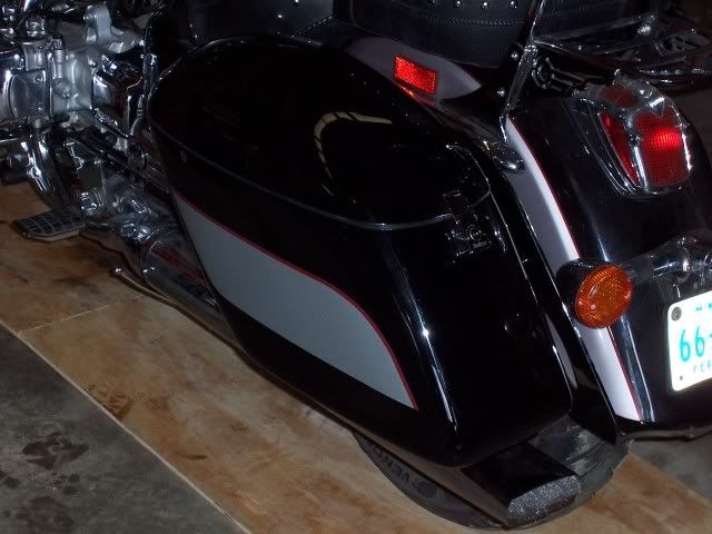

« Reply #4 on: May 26, 2010, 08:07:55 PM »
I installed a set of the Tsukayu "Strong" bags in addition to a Hic Doc trailer hitch over the winter. The "Strong" bags are a little smaller than the "Jumbo" bags. The bags did NOT have any holes drilled in them so that added to the install time but they are nicely made.  I had stronger keys made cause the ones that came with it were pretty cheesy.  All in all I would recommend them.  If interested I have more pics during the install.  If I remember I paid like $340 after discounts, coupons, etc. at the time. I added the silver graphics myself.

As far as the graphics go I just ordered some 4" striping material and cut it to the shape that you see. I was able to order 8' instead of the whole roll. Also got some 3/16" to match the maroon color.
http://www.stripeman.com/
Also, if you're not planning on putting on a trailer hitch as I did you may want to add the support brace that Tsukayu offer's to attach to the bottom towards the rear.  The trailer hitch offered additional support to the mounting brackets as they hang down. I had some diagonal pieces (1/4" alum.) fabbed up at work to go between the brackets and the bags which added more support to the bags.
