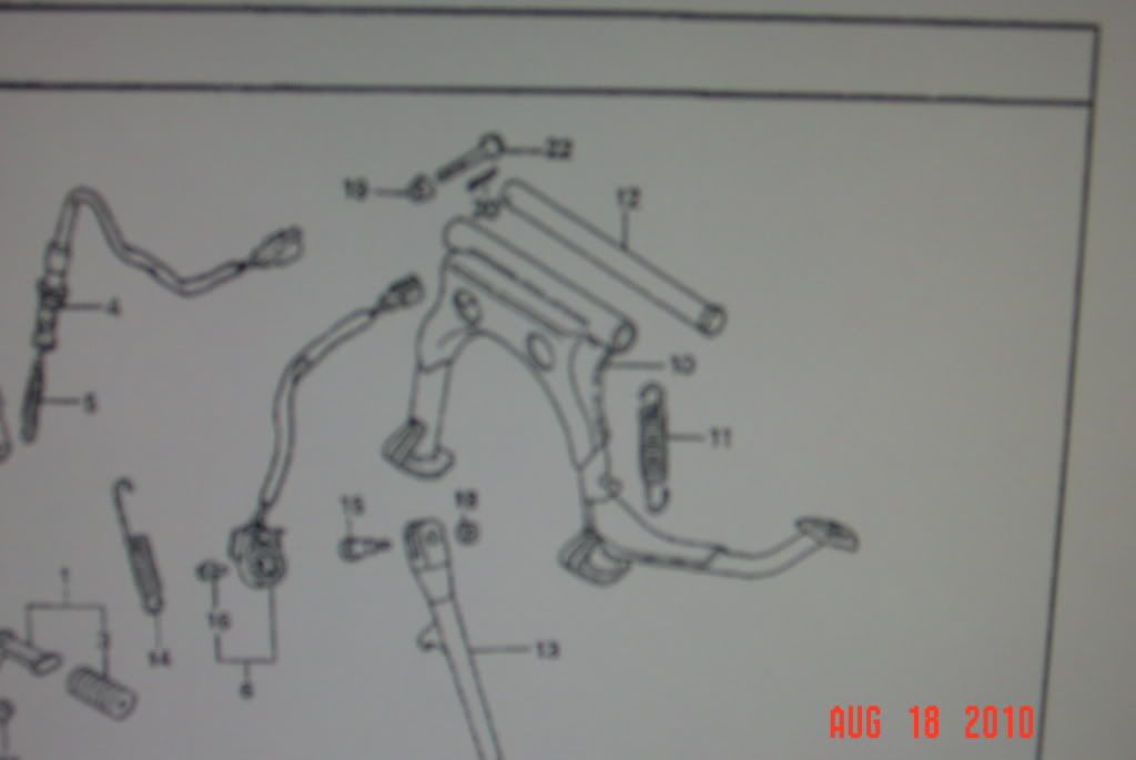

Rio Wil
Posts: 1357
« Reply #23 on: August 18, 2010, 08:26:19 PM »
I got this reply from BamBam:
Hey Skinhead,
  Yes I have the Goldwing 1500 centerstand on my Valkyrie Tourer but I didn'd do the job. I bought it on ebay and work perfect
on the Valk with no mods. The guy that sold it to me told me that was from a 1500 Goldwing but nothing else. I can take some pictures
from under the bike later this week and email them to you on the weekend. The only work is remove the bolt that holds the side stand and put the center stand and reinstall the side stand on top of center stand since both will use the same bolt to the frame. It took me
about 40 min  using the motorcycle jack .
Me thinks there is a terminology issue here, there seems to be a mix up between a center stand and a kick stand......here is a picture of a kickstand and how it is mounted to the frame crossbar.  Here is a pic of the schematic of a '99 GW center stand also.......can't be done easily!!!
Notice the mounting method of the two parts are vastly different.

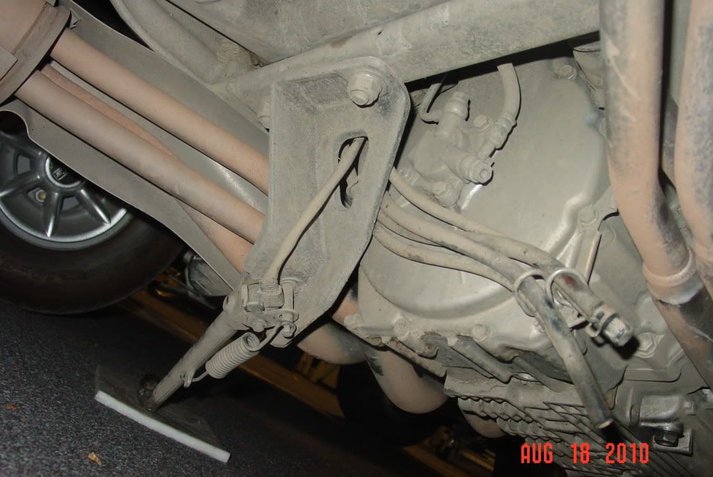

I have a Interstate in my shop right now with a 1500 center stand on it. I will take a few pictures tomorrow and try and post it. Looks from what I can see is a new type of mounting bracket to be built.

my measuring says that you basically have to build the upper half of a rivco center stand and the fab mounts on it for your 1500 lower. not hard but it will take a little time. can someone post pics and measurements of their upper mount from rivco?

Here are links to pictures of the Goldwing 1500 center stand on a 1500 wing. Took them of a buddies at work...
http://crbest.com/valkyrie/wingstand/01.jpg
http://crbest.com/valkyrie/wingstand/02.jpg
http://crbest.com/valkyrie/wingstand/03.jpg
http://crbest.com/valkyrie/wingstand/04.jpg
http://crbest.com/valkyrie/wingstand/05.jpg
http://crbest.com/valkyrie/wingstand/06.jpg
http://crbest.com/valkyrie/wingstand/07.jpg
http://crbest.com/valkyrie/wingstand/08.jpg
You can right-click and "save as" if you want the pictures...
I have even bigger pictures, if you want them, just email me, and I'll send them.
