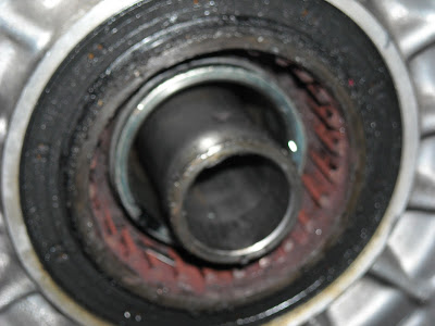

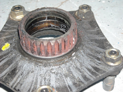

You'll need 30% moly paste (Honda Moly 60) for the drive gear and driven hub and to coat all the o-rings.  You'll need 3% moly grease or a good quality bearing grease such as Bel-Ray Marine for the pinion cup and the ends of the drive shaft.
There is no set interval for servicing the bearings.  Check them for smoothness by rotating them with your fingers.  Try and apply some side load as you do.  If you're not experiencing grinding feel or noises from the rear in corners, you probably don't need to mess with the bearings.

Don't forget to clean the holes at the bottom of the pinion cup.
And most important: Loosen the nuts that mount the rear drive to the drive shaft housing and re-tighten them LAST, after the axle nut has been torrqued to spec

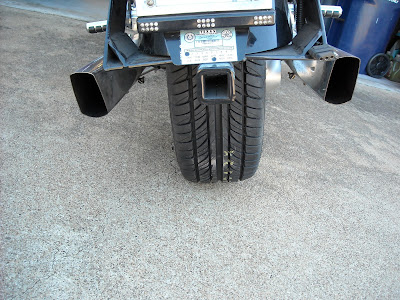

Discount Tire in Flower Mound mounted the DS tire, but couldn't balance it. I took the front tire ($41 for new Metzler off ebay  Cool ) to Denton Cycle Center to mount the new front and they balanced the DS rear with minimal lecturing.
Special thank you to HayHauler for sending me a couple metal valve stems - very cool.  cooldude
New 205/60-16 Falken Ziex ZE-512 Darkside - where's my cookie?
I'm glad I got the service done when I did. The splines looked OK, but as dry as the were they  probably won't have lasted that long.

Man, you should buy a lottery ticket as lucky as you are with those splines!
