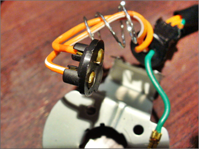

« Reply #8 on: November 01, 2010, 02:20:29 AM »
from a 2007 Shadow 600 front signals. I know .... it doesn't look like a bulb socket, per se, and yes, it's the same generic part used on a Valk. It's two parts. A socket plate and a plastic disc. All you need for the rear signals is the dual contact disc (wires too), and done. However, I'm not 100 percent sure whether a rear socket plate will accommodate the alignment knobs on a 1157 dual filament bulb. You could try fitting a 1157 bulb into the rear socket, and if it doesn't fit then instead use the socket plate from a front signal. The socket plate clips into a groove that's molded on the tip of the rubber stem that protrudes into the light shell.

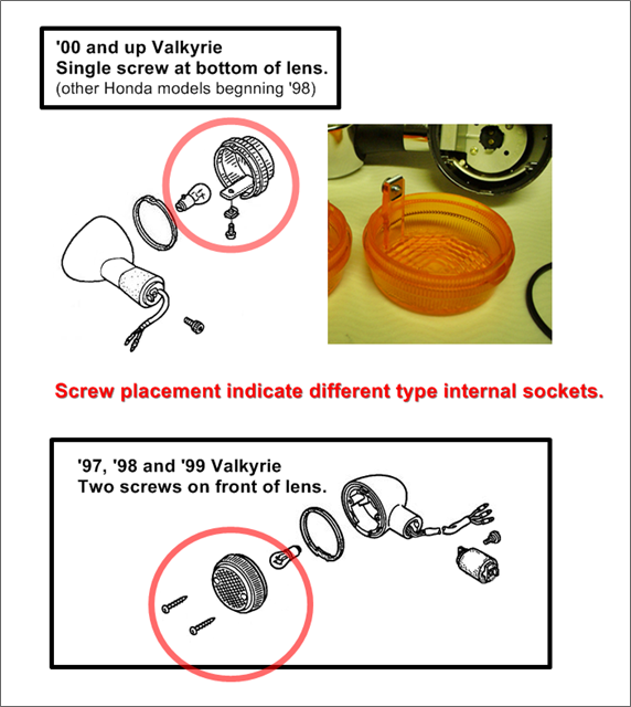

ricoman
Posts: 1888
Sarasota, FL
« Reply #11 on: November 01, 2010, 10:55:42 AM »
to clarify my earlier reply:
on 97-98-99 Valks (not IS) the rear turn signals have 2 screw lenses.
Inside the light assembly is a chrome plastic reflector which the lens screws go into and to which is attached a metal socket with a single contact disc (single filament) with 2 wires from it. The left has: green and orange, the right has green and blue. The orange and blue are hot for the turn signal, the green is ground. To use a double filament bulb you need to replace the single contact disc with a double contact one and get a source of power for the second contact. I sourced the 2nd hot from the license plate light.
The stock chrome assembly uses a single filament bulb and has slots for securing the bulb which are of equal depth in the socket as the bulb pins are equal, not like the offset pins of dual filament bulbs which would have one slot deeper in the socket for that bulb.
The stock chrome reflector/bulb socket cannot be changed out to the later model metal socket (they look like those in RONW's pics) as the later model reflectors are different and seperate from the bulb socket. Sooo, you need to install a dual contact disc in your stock reflector/socket and get a dual filament bulb with equally spaced pins.
OR, as noted by Shortleg, just get a set of front signals and put the insides in the rears.
Had I known that I would not have had the hassle I did to convert.
Or, get a SignalMinder fron KissenTech, install it (plug and play) paint lenses red and you will have run/turn and four-way flashers for about 110 bucks.

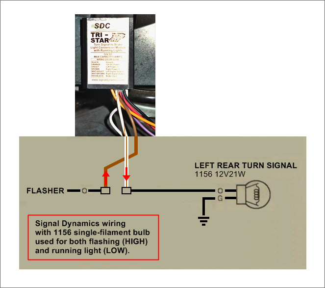

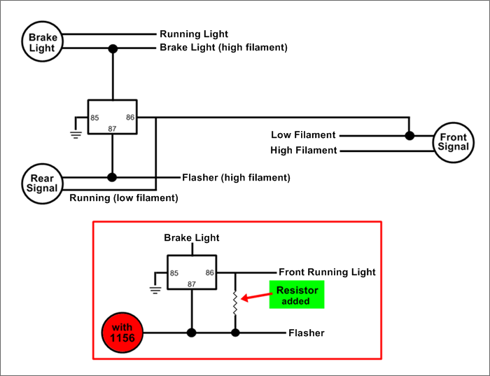

« Reply #12 on: November 01, 2010, 10:07:19 PM »
If you tap the front signal's low filament wire to power the rear 1157 bulb's running light, this is about the same schematic that most people will arrive at. Wired this way, the brake input will be disabled to the rear signal that is flashing. Also, the low filament will be OFF in the same bulb for the duration that the high-filament flashes, mimicking the front turn signal. There are already brake/run/turn electronic modules that do this, and they even retain the stock 1156 single filament bulb in the rear. I believe the units emulate the lower brightness of a running light by sending less amps to the 1156 bulb for running light mode. So I've thought that perhaps it's possible to leave the 1156 bulb in place and solder a resistor in-line which would lower the rear bulb's brightness for running mode (inset diagram). The only real need for a 1157 dual filament bulb is for its low-filament, the high filament is already there in a 1156. Note: with front turn signals, when the low filament is ON, the high-filament is OFF in the same bulb, and vis-a-versa. The opposite on/off states allow the brake input in the rear signal lights to be synchronized using relays so it doesn't interfere with the signals flashing.
An 1156 bulb has a resistance of about 6 ohms, and draws about 2.1 amps.  To cut the current in half, you would need a 6 ohm resistor rated at 10 watts to give some overhead to the 6+ watts the resistor would dissipate.  The resistor would get quite hot, so it needs to be mounted where it can get some airflow, or to a heatsink.
A better method would be to use a power transistor to run the bulb at 50% duty cycle.  That way you wouldn't be dumping the excess power as heat.

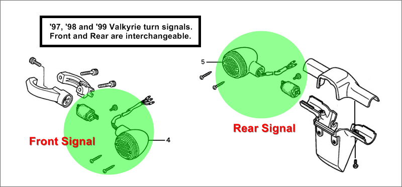

RonW
Posts: 1867
Newport Beach
« Reply #18 on: November 04, 2010, 02:27:24 PM »
....on 97-98-99 Valks (not IS) the rear turn signals have 2 screw lenses....The stock chrome reflector/bulb socket cannot be changed out to the later model metal socket as the later model reflectors are different and seperate from the bulb socket.
2000 Valkyrie Tourer
RonW
Posts: 1867
Newport Beach
« Reply #19 on: November 04, 2010, 02:29:55 PM »
An 1156 bulb has a resistance of about 6 ohms, and draws about 2.1 amps.  To cut the current in half, you would need a 6 ohm resistor rated at 10 watts to give some overhead to the 6+ watts the resistor would dissipate. The resistor would get quite hot, so it needs to be mounted where it can get some airflow, or to a heatsink. A better method would be to use a power transistor to run the bulb at 50% duty cycle.  That way you wouldn't be dumping the excess power as heat.
For the reasons you noted, the Signal Dynamics® et al. run/turn/brake units probably do have power transistors integrated in their modules. I'll be remiss not to mention that any electronic hobbyist with a soldering iron could rig a circuit board for a run/turn/brake unit with one hand tied behind his back. There's not too much to these things with the proper equipment. The obvious advantage of store bought run/turn/brake units is that it spares all the hassle and untold hours spent piecing things together. I've installed a run/turn/brake unit on another bike of mines. The biggest disadvantage and it may be only with me, is that you have to cut 2 particular wires in two (pic below). It's bad enough having to cut apart the pristine wire sheathing in order to reach those wires, much less preform surgery. On the other hand, the plus side is that the modules allow you to retain the rear 1156 bulb without further modification to the rear signals' circuits since all the necessary transistors (switches) are embedded in the same package. The Signal Dynamic® module in the bottom pic is shown about actual size.

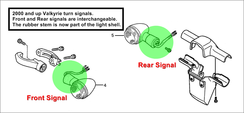

RonW
Posts: 1867
Newport Beach
« Reply #20 on: November 04, 2010, 02:36:43 PM »
Why gut a front turn signal, just put the front housing and all in the rear, with your rear lenses?
Absolutely. It just so happens that the front and rear signals are interchangeable with each other on Valks. How many times does that happen in the same century. For 2000 and up, you do have to install the signals kitty corner, since 2000 and up have a screw on the bottom of the light shell and a left-to-left or right-to-right swap would place the screw on the top of the light shell since a FRONT signal installed on the same side REAR would have to be installed upside down in order to face it in the opposite 180 degree direction. You'll see. There's a little cross-up with the wire color code too. For example, ORANGE (honda left) wire will be on the right side of the bike done this way.
Btw, a reason why you might gut a front signal is that most other Honda cruisers, after or before '98, use the same generic light bulb sockets in their turn signals. In that sense, you're not limited to Valks for this particular part.
« Last Edit: November 06, 2010, 01:54:27 PM by RONW » Logged

ricoman
Posts: 1888
Sarasota, FL
« Reply #21 on: November 04, 2010, 03:01:18 PM »
great pic, makes my point more understandable (even to me)
where did you get it?
RonW
Posts: 1867
Newport Beach
« Reply #22 on: November 04, 2010, 04:21:02 PM »
the diagrams from OEM websites with the pertinent parts cropped. The photos were taken earlier, last year, forgot already, though occasionally people have a tendency to believe that I took the elevator down 20 flights exclusively to take a pic of my bike in the parking basement so I could reply to their post. I've gave up on trying to write out what a pic could describe more clearly, mainly to avoid the, whoops, we're not even on the same page. Very informative of you to mention the two screws on the front lens of 97-99 Valks.

Posts: 5196
« Reply #23 on: November 04, 2010, 11:20:27 PM »
If you install standard 1157 bulbs in the rear with the supporting mods needed, and have luggage, the pods don't get enough cooling air and the inside plastic supports melt and the guts drop out.  At least in the summer & daytime.  I melted two pairs of rear pods this way.  Then I installed a night switch so the running lights were only on during the cooler nights.
I have since changed the pods to clear lens ones for the VTX, and installed LED panel "bulbs".  I think they have 24 LEDs ea.  Mine are set up as run, brake and turn using relays and the front marker light circuits to control the relays - whether they select brake or signal circuit directed to the bright filiments.  BTW this can be done with single-filiment bulbs with the circuit I designed, using the optional diodes and resistors.  See my writeup on my tech pages at http://www.horseapple.com/Valkyrie/Tech_Tips/VTX_signals/vtx_signals.html
I've been running this circuit for full-function rear lights for about 8 years now and it has been dead reliable.  Though I've improved it a couple times by changing the pods and going to LED's.  The circuit costs only $10 for the relays, maybe the same for wire, diodes and resistors, and takes an afternoon to install.  A little more if you bother to go to 1157 sockets - which isn't necessary but I did it before I realized the circuit could be designed for single filiment bulbs.  Going to VTX pods is quite expensive, and they are single filiment - but have clear lenses and a more streamlined profile, if you want to change the look.
Here's what the circuit looks like:
« Last Edit: November 04, 2010, 11:26:35 PM by MarkT » Logged

RonW
Posts: 1867
Newport Beach
« Reply #26 on: November 06, 2010, 09:12:51 AM »
fantastic. I've never seen the 87/87a terminals used as inputs. Obviously, they're bidirectional. Almost poetic how well it works for this situation.
« Last Edit: November 06, 2010, 09:16:02 AM by RONW » Logged
Posts: 5196
« Reply #27 on: November 06, 2010, 05:23:35 PM »
Back in my geek days, we used to call such a solution - w/o wasted effort or parts, everything in harmony - as "elegant".
