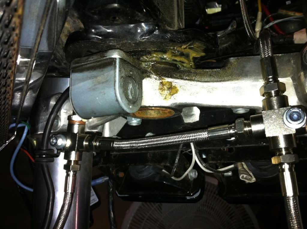

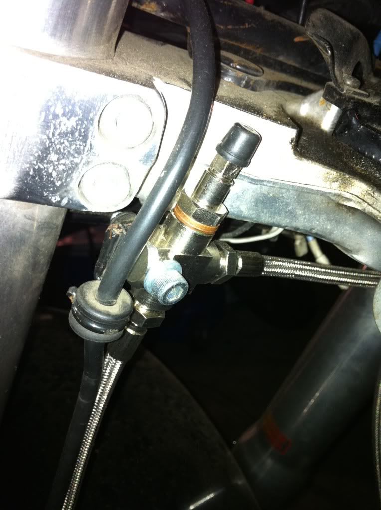

Here ya go,,,hope these help ya.
Left side and the bleeder that came with the lines.
Here is looking at both sides from the left side (Clutch side) of the bike.
This is from the right side (Brake side)of the bike

« Reply #9 on: November 26, 2010, 08:18:11 AM »
Thats what we needed ! Thanks Fordmano. That is not even remotely what was sent to Early Bird or the SS I have on my Valk.

« Reply #10 on: November 26, 2010, 08:39:04 PM »
Is that an Interstate mounting?
On mine the bolts screw from the bottom UP.  This puts an unnatural bend (kink) in the lines going down to the calipers.
Thanks for going to the trouble of taking and posting pictures.

« Reply #11 on: November 27, 2010, 01:38:44 PM »
Yep thats a I/S setup. I had to go and buy longer stainless steel bolts to use the stock hooks for the speedo cable/wire.
Your very welcome for the pictures I have to measure but I think I installed the lower sections of brake line upside down since the original mounts or guides on the front fender don't match up with the thick part of the new line.
