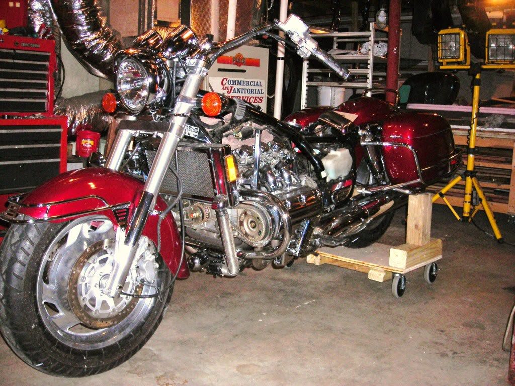

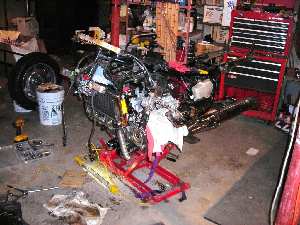

Almost done.  Waiting on the tank do be done.  I can't believe how much work and time it took but it was/is a labor of love.
List of what I had to do because the PO had crashed it.
New paint, new right crash bar, new right mirror, new to me right valve cover, new front brake caliper cover. Straighten out right foot peg, radiator brackets, bag guards, bag frames and back rest.

i like that caddy for the rear wheel, makes moving it around so much easier!!  good job!  i know what it's like to work on your cycle months on end to get it ready to ride, all those days and hours in the shop do pay off!!
Posts: 6899
« Reply #4 on: April 07, 2011, 05:12:54 AM »
That caddy is the best thing I've built this year (works been slow).  Made it out of scrap wood and some wheels I had hanging around for a couple a years.  It's unbelievable how easy it makes moving the bikes around.  There's 5 lally columms surrounding the bike in that pic, used to take 10 mins of back and forth till I had that caddy light bulb go off.

I'll measure it up and post it.  I use the bike lift and lift it enough to get stands under the front crash bars, then let it down, then remove the bike lift.  Then I use a car jack under the swing arm with a block, get high enough to slide the dolly under the rear crash bars, then let it down.  Then I use the car jack to lift the front and remove the stands. The bike always has a 3point lift except when using the bike lift, but that's solid enough for the short time it's used.  Alot of jockying around, but it's still WAY BETTER than the rolling it back and forth crap.
