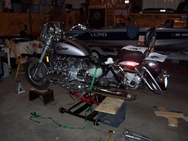

Thanks .... I took an old plastic mud flap and cut it to fit on the adaptor to help keep mud, dirt, water, etc, off the horns. Drilled and tapped some holes in the adaptor and used SS fender washers. They have been on there now for two years and no problems. They are LOUD !!
It helps to use a wheel chock to hold the bike up while you're putting on the PRO LIFT adaptor .... especially if you're by yourself !!
Without the mudflap piece and horns ....

I used a couple of jack stands on the crash bar to support the bike while installing the adapter

Might depend on what lift you're using .... I use a Pit Bull and it will lift it evenly and can remove either front or rear wheel but I placed a support under one of wheels for peace of mind.
