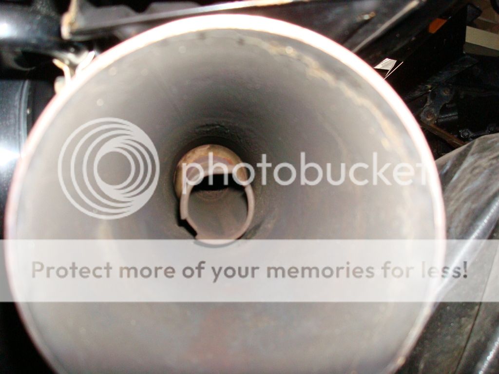

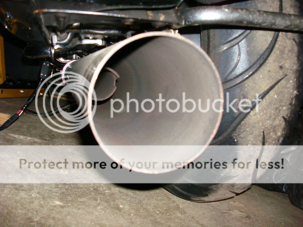

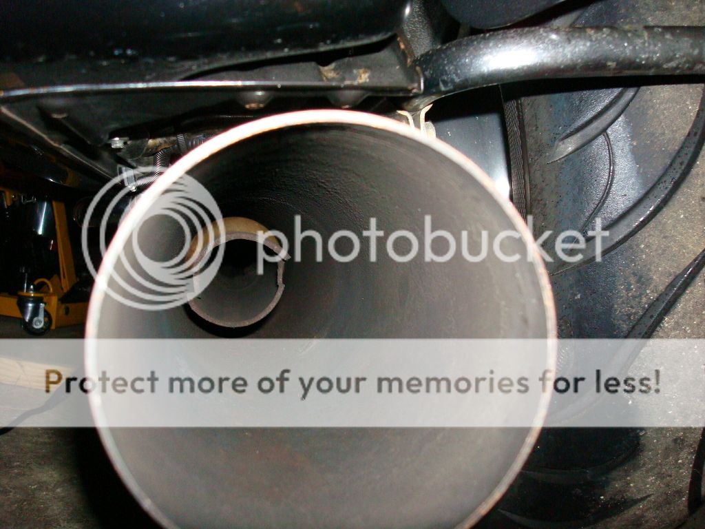

Not my valk either but if you are talking about the mod where the glasspack is threaded to a modified header inside truck stacks I can help you out Grin  My '01 valk has the glasspacks that are notched on each side of the outlets so you can make a "T" tool to thread them out of the headers.
Granted it's pretty hard to get a good picture inside a 4" pipe of the glasspack that is in there but here you go.
The outlet is tweaked a little on this glasspack:
The glasspack outlets are up in there pretty far......maybe about 12" (never actually measured it)

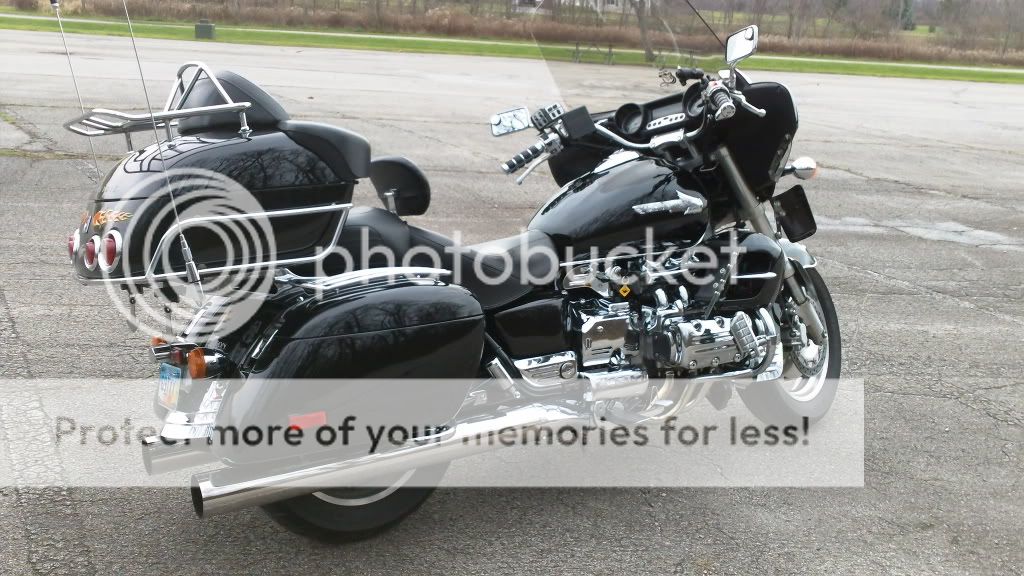

A side shot for reference:

Slayer , you won't get those out with a T Tool.
Take the skins off and a big pipe wrench will do the job.
I put antisieze on them so thy will come off easier this time.
They once had a homemade baffle in your pipes, that hushed them downa little.
But I wanted them louder and they are loud.
