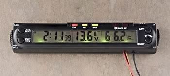

I had one of those on my Fat Lady for a couple of days,,,,, DID NOT like it. Maybe I did something wrong or I just got a bad one,,,but.
The display stays on ALL the time the back lighting goes off but I would not call what mine had as back lighting more like "mood lighting for fire flys" could not see it beyond total darkness without lookin at it at an angle. would constantly beep everytime I switched any of my AUX lights on or off, oh and the best part was actually a noticable draw on the battery would drop the battery voltage about .4volts a day when not riding.
Hope you have better luck than I did with mine.
I read reviews and a few people say these are VERY sensitive to moisture.

the voltage meter
Stanley Steamer
Posts: 4990
Athens, GA
« Reply #13 on: May 16, 2009, 07:35:31 AM »
the voltage meter
that when wet, the display would go out until it dried out again..I'm really only wanting it for the voltage feature anyways, although the temp would be nice...the I/S's already have a clock on the display..
I  guess I could hook it up to where it only comes on when the bike is turned on?..I have a small lighted blue switch for my green LED lights and it only has a small battery drain usage...
I checked my battery a few minutes ago and it was showing 13.6 volts...
