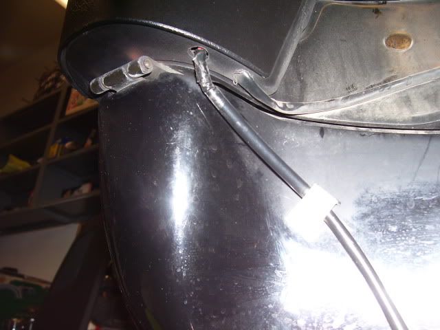

Ok Hope these help. The wires go in the bottom of the speaker pods. Two holes under the right side one and one hole under the left. The wires come up along the fender rail and are tucked in behind it. The white j hooks look to just be 3M taped on. You can actually see the one on the lower right (left in the pic) with the seat on, and I hadn't even noticed that before. Wires are in a black plastic sleeve and sort of blend in with the surroundings. Don't mind the dirt, as I haven't started cleaning the trunk area yet.
This one has the wire untucked from the fender rail.
With the seat-back on.

Thanks y'all.  cooldude Helped a lot.
