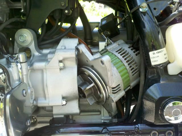

Confirmed that my alternator was not charging and pulled it.  That's a bunch of fun!  Although, squeezing the alternator out of that tight hole was easier than pulling the center cover out.
Now that I have it sitting on the old work bench, I'm looking for a rebuild guy.  It appears that MARS is out of business - email bounced back anyway.  I recall something about him closing up on the GoldWing site.  Any other suggestions other than buying new?  Or if new is the only alternative, any suggestions as to the best place for price?

Get yourself an alternator for the Goldwing 1500 series, '99 OR 2k and clock it for the Valkyrie. Lay the alternators side by side, remove the three screws and rotate the front or pulley end of the alternator to match the Valkyrie alternator. The Goldwing is the same alternator and somewhat cheaper.

I seem to recall this is a common problem with valkyrie alternators.
http://www.valkyrieforum.com/bbs/index.php/topic,30026.0.html
After seeing the pictures in that thread I examined an alternator I had replaced a few years ago. The wire was broken in exactly the same location.

Any competent automotive electric shop should be able to rebuild your alternator, most fair sized towns will have one or more .  Hoser

With only 32k on the clock I would think the broken wire may be the issue.  They should last longer than that.  I take it that it will need to be re-wound since there isn't enough wire to make a repair connection.  I have not pulled it apart yet to inspect.
On the old thread, someone asked the advantage of going to a 90amp vs the stock 40amp.  Any thoughts on this, since it wasn't really answered?  I know on the Wings, everyone was going with the 90's.
'Competent automotive shop' hmmm - is there such a thing?  I had issues having my septic pump re built by a reputable shop.  I may end up going with a new one and keeping this one to have rebuilt one day for a spare.
It was necessary to remove the center panel to get the alt out.  As stated in previous posts I found in my search, you just have to hold your tongue right and curse a lot for both of them.  Installation is reverse, so does that mean I have to hold my tongue the opposite way?

I have had my Interstate alternator out and in three times and never had to remove the center cover to do it.  It is not easy to get the center cover out and back in (did it once) so it is good to know that it is not necessary.     Larry

I took my alternator out and did not remove the center cover.I also went with a 85 amp. alternator  made for a Gold-wing and just clocked it to fit the Valk.Some day I'll have my 40 amp alternator rewired for 90 amp.(the 40 amp.alt.was still good  my volt meter was bad)

That's a link to an eBay auction (no affiliation) with an 85 amp Giold Wing 1500 alternator. If it's as easy as 'clocking' the GW higher output alternator that may be the best course of action for you. It would be nice to have double the alternator output if it's an easy plug and play Honda part.

That may be the ticket!  I'm sure it's made in China.  They list a 40amp for the Valk.  One Valk owner in Mexico bought one and gave possitive feedback - I wonder if he's a member here.  They also have an 85amp on sale for $180 w/ free shipping.  Hmmmm!  They have good feedback.
Thanks for the heads-up Mark.  I may be the guinea pig here.  Afterall, it's just a tow away from home if it fails  uglystupid2

I've removed/reinstalled more alternators than I'd like to count.  I've found that pulling the center cover is not REQUIRED, but certainly makes life easier.  It's worth pulling the cover, to me.  Have a long screwdriver handy for the tip-over switch, but all that is easier than getting the alt. out without pulling the center cover.

I had Ken's old email address.  I just got off the phone with him and he is still in business.  I'll be getting my replacement from him.
