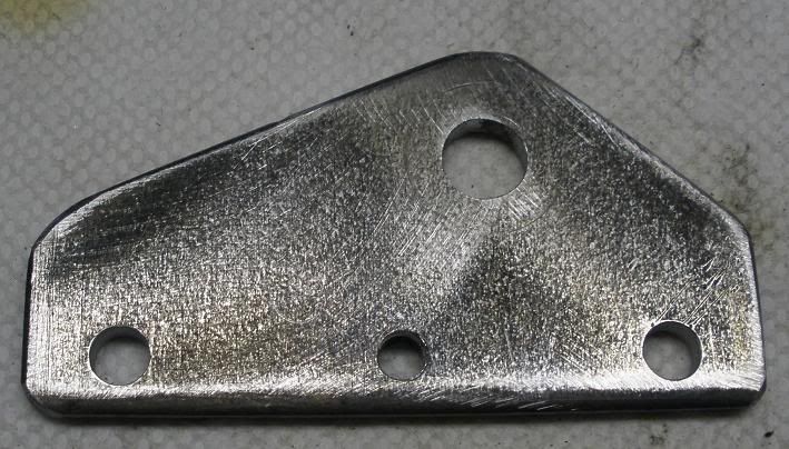

« Reply #7 on: April 26, 2012, 10:36:19 PM »
After the original horn bracket broke, I threw the original and the rivco mounting brackets away and made the following 3/16 thick steel plate to mount my Rivco horns.
It holds my horns very securely and very close to the radiator side cover.  Please excuse the nastyness of all the bug gut on the chrome.
A close up of the supporting side shows the stack of extra heavy washers that hold the plate out from the frame.  I plan to make a one piece spacer for this and weld it to the plate but for now these heavy duty washers are doing great.  You will notice one washer has red paint on it.  Yes, I know but I was in a hurry to get the horns back on the bike.
The horns themselves bolt directly to the outer holes in the plate, the hole in the center is tapped for 1/4 - 20 bolt to hold the cover on the horns and the large hole is for the 10mm by 1.25 by 100mm long bolt that replaces the original frame bolt.  The 10 mm bolt goes thru the plate, then thru the washers and then thru the frame and radiator support.  The stack of washers add up to about 1 and 3/4 inch.  That gives about 3/16 inch between the horns and the radiator side cover.
I will replace the washers with a piece of heavy tubing welded to the plate when I do my winter maintinence but will be doing that just to clean things up a bit.  The horns look great as they are and they are solid as a rock.

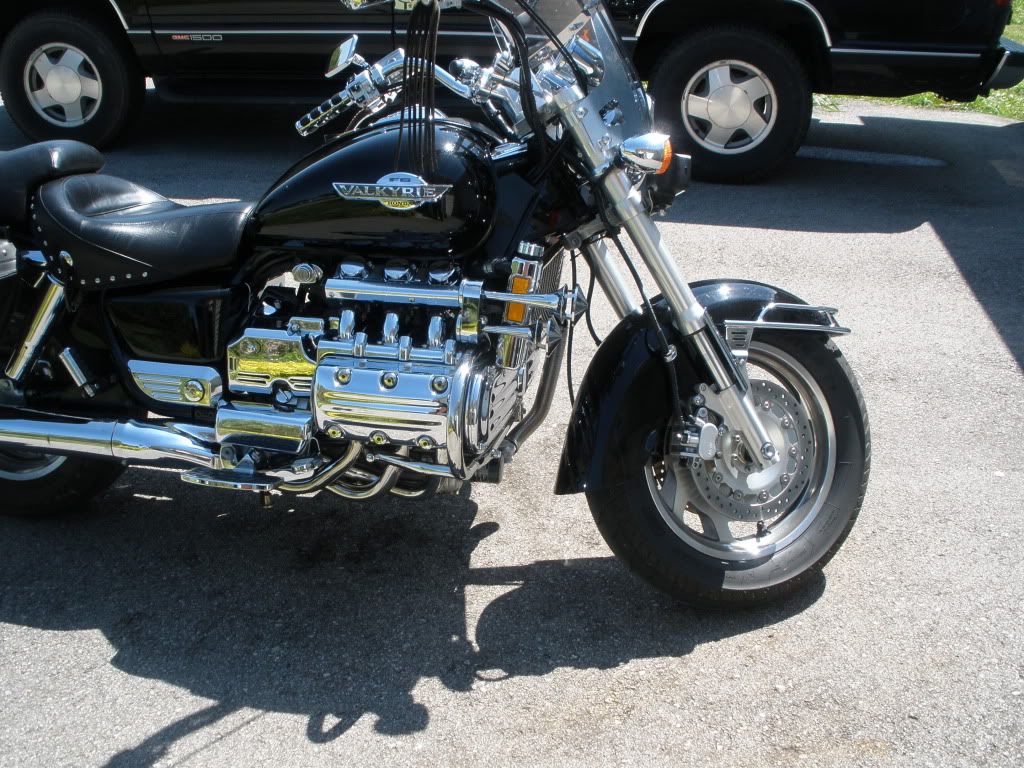

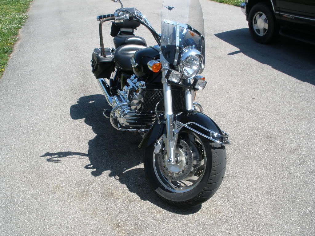

« Reply #10 on: April 28, 2012, 02:00:55 PM »
Here's how I did it.
First I got a bracket like this
Then got a exhaust hanger shaped like a "L"
Put them together with the bracket Rivco provided and got a nut cap.
Very solid, never had a problem on both bikes I have that on.

« Reply #12 on: April 28, 2012, 08:32:50 PM »
Where do you get these brackets?

Posts: 6501
« Reply #16 on: April 29, 2012, 02:52:40 PM »
Sorry, really can't remember.  Could be JC Whitney or one of the many aftermarket stores on the web.

« Reply #17 on: April 29, 2012, 06:26:53 PM »
JC Whitney motorcycle catalog, webpage  http://www.jcwhitney.com/3-piece-clamps/p2017507.jcwx?filterid=u0j3  Hoser
