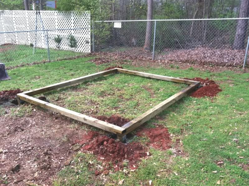

..... I did stay in a Holiday Inn once.....and decided to build a little greenhouse......8'x10'.......

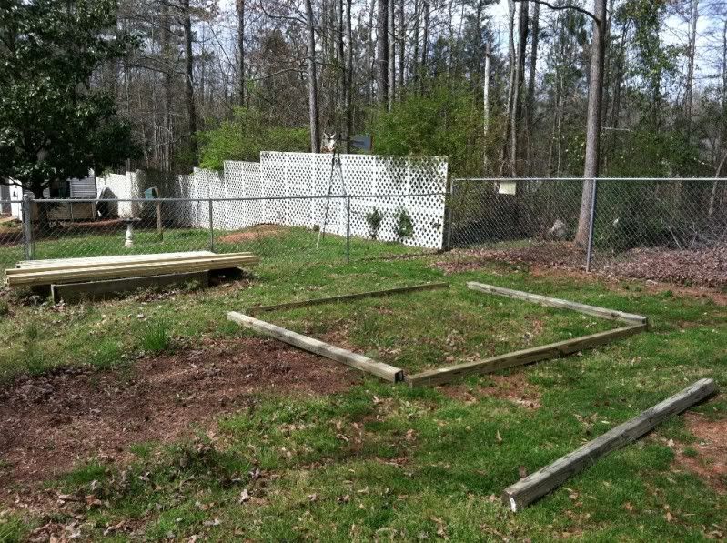

started out as a pile of lumber......
little bit of saw work.....

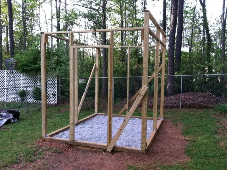

a few screws.....
a little post hole digging......

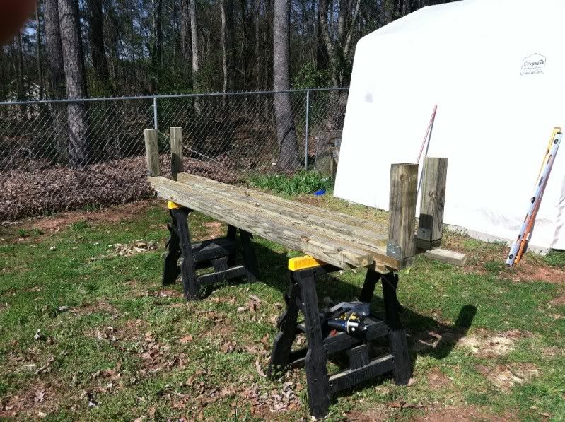

Don't forget some screws in the legs......

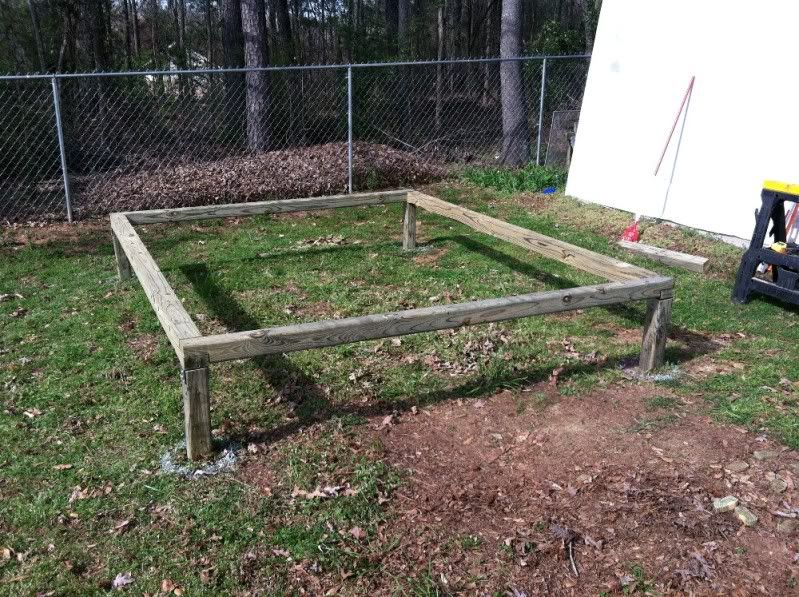

Mix a little concrete in a wheelbarrow.....make sure the foundation is level.......

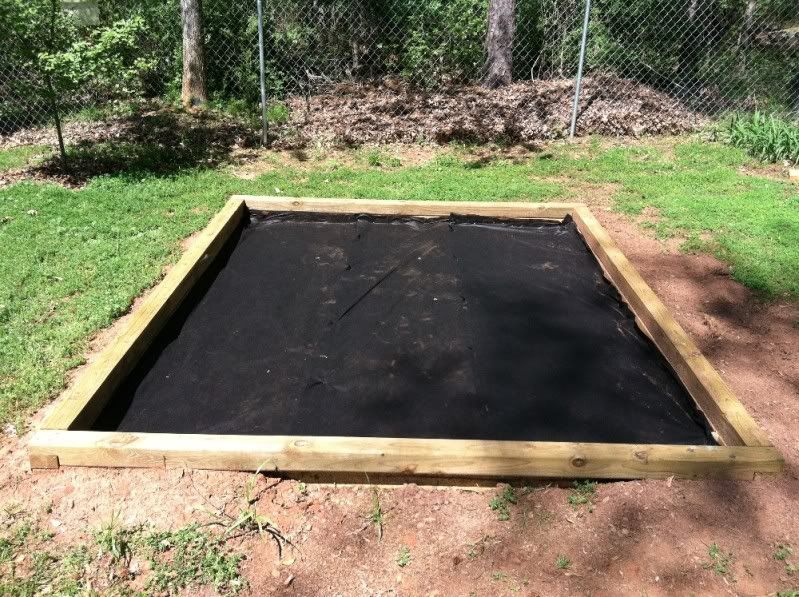

Dig out the middle to make room for some gravel......

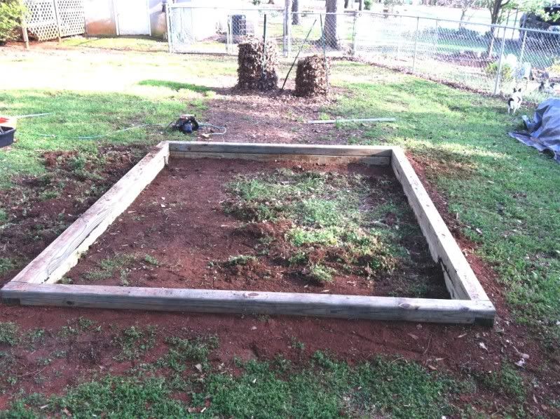

Add some landscape fabric......to keep the weeds from coming through the gravel......

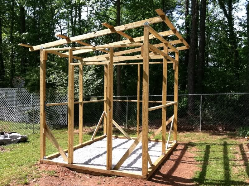

Wheel in 2,700lbs of gravel......

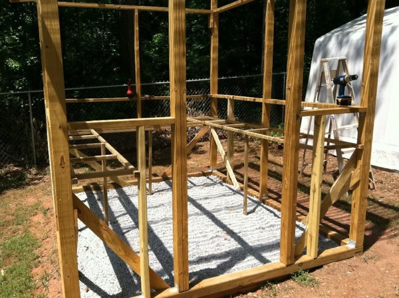

Round up a few tools....assorted metal brackets, screws.....and let the party begin.....
Slowly but surely it starts to come together....

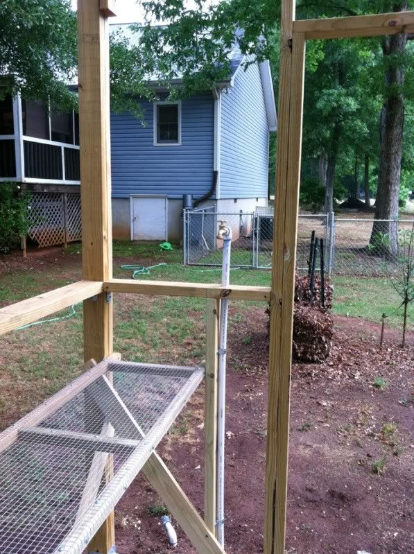

Add an inside water spigot ......

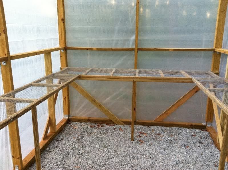

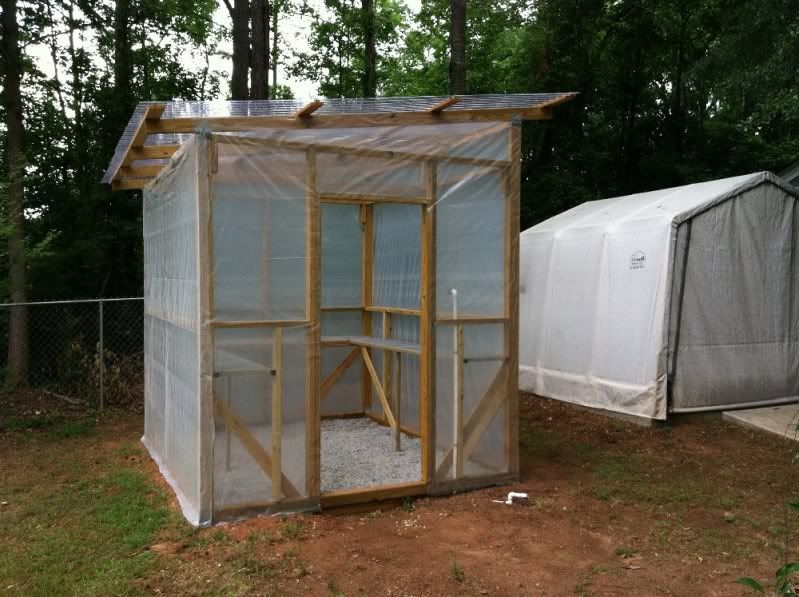

Add the shelves....

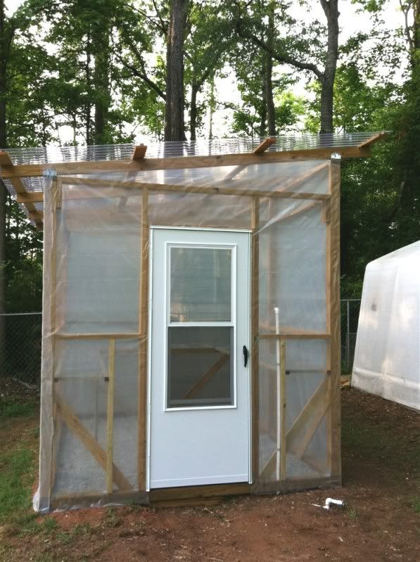

Add some plastic to the sides.....just a temporary thing until I add the poly to the sides later on.....

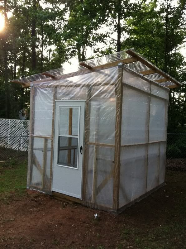

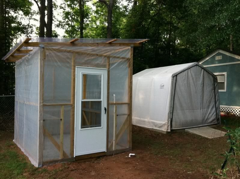

Time to add the door.....
I guess the Wife is right.....no room left in the backyard for anymore buildings!!........ Cheesy
Guess it's time to add some plants and see if it was a good idea.......hope it wasn't a waste of a $$....... cooldude

« Reply #1 on: May 15, 2012, 06:33:39 PM »
extending the tomato season?

« Reply #3 on: May 15, 2012, 06:36:44 PM »
Nice job Mr Steamer.   You may want to consider adding a vent/fan at some point to keep it from becoming a sauna in the summer - might not be a necessity in your climate, but something to consider.
-RP

« Reply #5 on: May 15, 2012, 06:40:24 PM »
-RP
I left the area above the top sill open on both ends.....to let the heat out.......and when I put the hard, clear siding on it, I plan on adding a hinged vent on that taller right side.....the door has a screen on the bottom.....cool air in and hot air out the top....... cooldude

« Reply #7 on: May 15, 2012, 07:02:23 PM »
looks good. BUT as a professional I just wanna put it out there that pouring concrete around posts..especially non pressure treated will cause to posts to rot twice as quick..for 2 reasons.. reason 1 is the acids in the concrete..reason b is water that gets in between the crete and the post cant get out.. jus sayn
I have gravel in the bottom of the holes and it is pressure treated wood.....it'll be there long enough to get my $$'s worth out of it...... cooldude

« Reply #10 on: May 15, 2012, 07:15:31 PM »
well cool.. from 2500 miles away it looked like yellow pine.. I just built 3 fancy greenhouses with thermostatically control venting and fans which is spendy.. that said ya MIGHT need some sort of exhaust fan rather than just openings.. ona those thermometers with a deal to tell you how hot it got while you were at work might be a good investment..

« Reply #12 on: May 15, 2012, 07:18:44 PM »
yeah.....I'm going to install some venting when I add the poly to the sides.......and also an irrigation system.....just been working on it a little each evening......

forgot to ask, why the need for the screws sticking out in the legs?  Is it to help anchor the wooden posts in the cement so it doesn't shift or push up overtime once concreted into the ground?
Stanley Steamer
Posts: 4990
Athens, GA
« Reply #27 on: May 16, 2012, 10:55:12 AM »
Exactly...... cooldude
