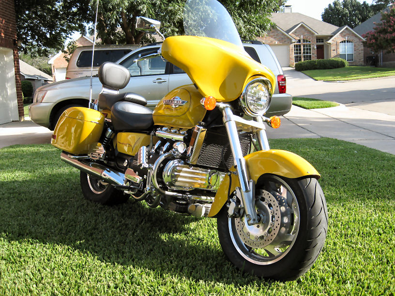

« Reply #42 on: January 17, 2014, 02:48:38 PM »
What kind of fairing is that? I like the idea of not having to move or cut up the gauges. Beautiful yellow!   cooldude
Valkpilot
Posts: 2151
What does the data say?
Corinth, Texas
« Reply #43 on: January 17, 2014, 04:59:12 PM »
Thank you.
It's a Harley fairing from mid 60s to mid 80s FLHs.  Paid $60 on ebay.
Had to enlarge the opening for the headlight.
Traced my Memphis Shades brackets, cut them from stainless and married them to the HD brackets that came with it.  I can go from fairing to windshield in about 15 minutes using the Memphis Shades fork clamps.
It's not fancy on the inner side.  I could do something about that, but don't have the ambition.  I sprayed the inside with textured pickup bed liner.
