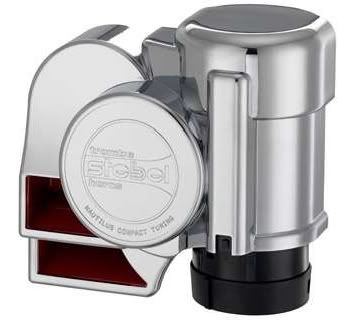

+1 on stebel/wolo.  One tip if you go with this horn is throw out the relay that comes with the horn and buy a good one instead.

There is the new chrome stebel compact tuner which is supposed to be 100% waterproof but it is 2-3 times the price of the Wolo Chrome bad boy.
