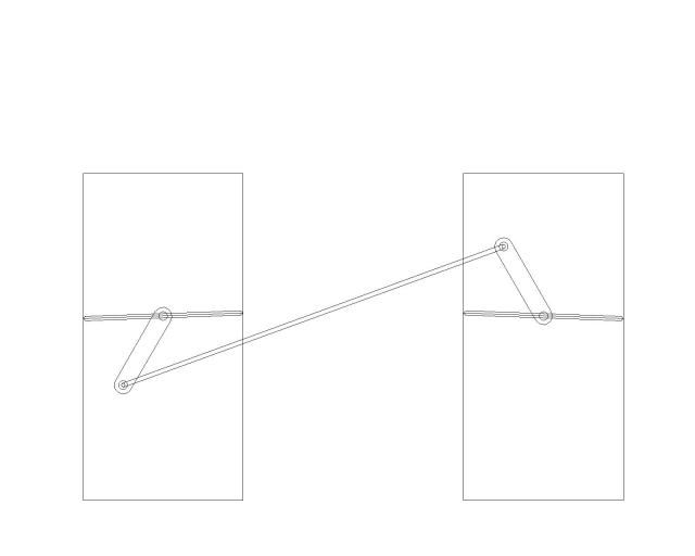

I'm looking for something simple to simulate mechanical motion with linkage. I'm working on a dual carb project and want to work up some methods of operating them accurately. I can find some modeling software, but they seem to be too simplistic, or to complex. I don't need 3D modeling. I just need something that will simulate motion.

Went old school. I set up an indicator on each carb. There is so much slop in the carb arms this is going to be tough to tell if it's going to be OK.
Right now one side is 1 degree faster on both ends of the scale. If I set them the same at half throttle, they are +1 on idle, and +1 at WOT.
Move this to the tech board please.

Jeff, with a plus reading at each end it sounds like you need to lengthen the arm on that carb which will reduce amount of travel of the throttle shaft in relation to the other carb. Straigthen the offset in the arm a little
Would not need much to correct that little bit of difference

Yeah, that is the plan right now. I figured id tweak the arms a tad and go with it. The carbs themselves aren't all that precision. I miss spoke earlier, its 5 degrees off at each end. But it's not a lot in the scheme of things. I can get half of that out of the slop in the mounting of the arms themselves.
I made a spool for the throttle today I'll shoot a pick tomorrow after I get a mount fabed up and everything powder coated.
