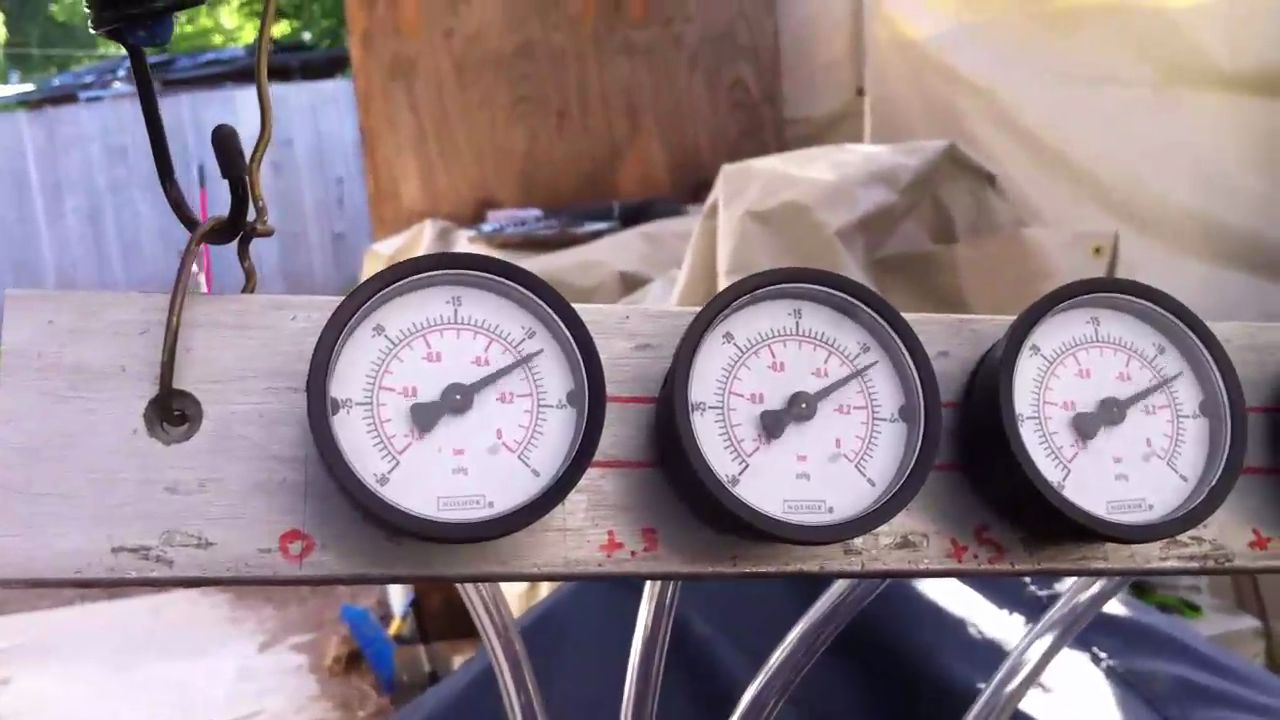

Here's my H.F. setup in action.  Gauges on sale $10. each & drip water system valves 10 for $12.
http://www.youtube.com/embed/1imfVbe9V7w

You can hook all six gauges up to a common manifold to be able to compare each one to all the the others.
Took me ten gauges to come up with six all pretty close to each other.
This is exactly why I purchased 7 guages got lucky they were all very close, definatly close enough for this task.
I think I only gave in the $4 range per guage then I used brass air shut off valves (so they would stand up to any fuel or fuel vapor and heat) from fish tanks to act as my dampning source for each line I think I gave about $1.50 each for those. Found my guages and valves online gauges from EVIL-Bay and valves were from a fish tank suppy store (Aquacave.com I think).
With 6 guages there is no guess or estimating or remembering what you saw on the last carb. I ain't the sharpest tool in the shed so I needed any way possible to make it easy. uglystupid2 crazy2
Like another said to each to there own, whatever works best for you is the way too go. cooldude
Too test the guages and the valves I made up a little manifold with brass "T's" and attached everything together then applied a constant vacuum with my mightyy vac and left it over night when I came back there was ZERO vacuum loss and I was able to note down each gauge as to what the readings difference was and they were all .5 or less different from one and another.
