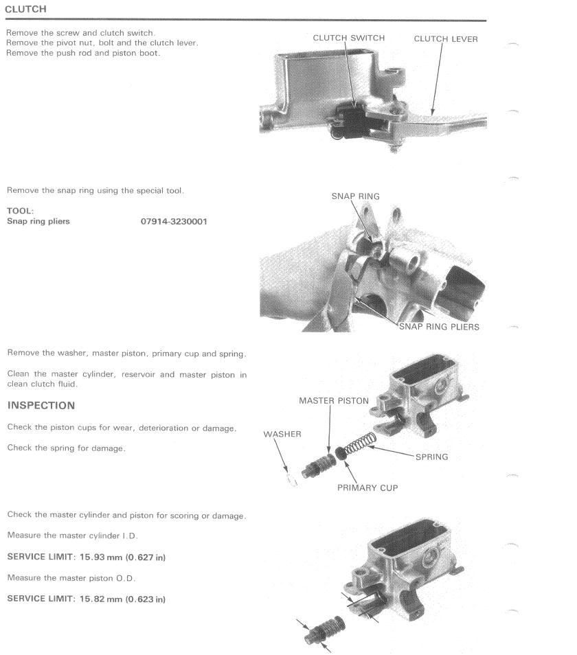

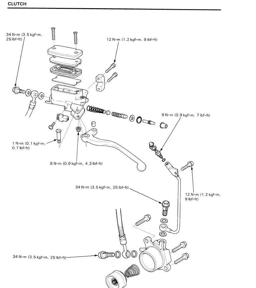

Is the top dia from some other bike? Wondering if the second spring is in there? and what is the check valve thing @ the slave plumbing!  Smiley
Ok I C its from some other bike! Sorry!

Both the pictures are from the Honda Valkyrie Service Manual and are accurate diagrams of the Valkyrie Clutch hydraulic systems.

Daytona, man, I hope you are just kidding  uglystupid2
You are really funny if you are kidding ha, ha, ha,
Well I changed the oil to DINO 10w30 with no friction modifiers and put on a new filter.
Man is it noisy now, sounds like I need to adjust the valves!  Shocked
Unfortunately no significant mileage yet, but for the 100 miles or so I put on it today it is still slipping when I really get on it.
Hopefully it helps soon.   Undecided
kiddin! about what? The first dia doesn't seem to fit too me! and the only prob any oil willcause with a clutch is the friction modifiers, energy conserving. Here is a pic of the clutch master from the parts fisch on this site, sounds like your disc's are gone! change em B 4 you have to do the whole thing. JMO.
