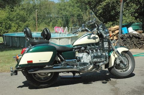

Here is a pic of the bike.

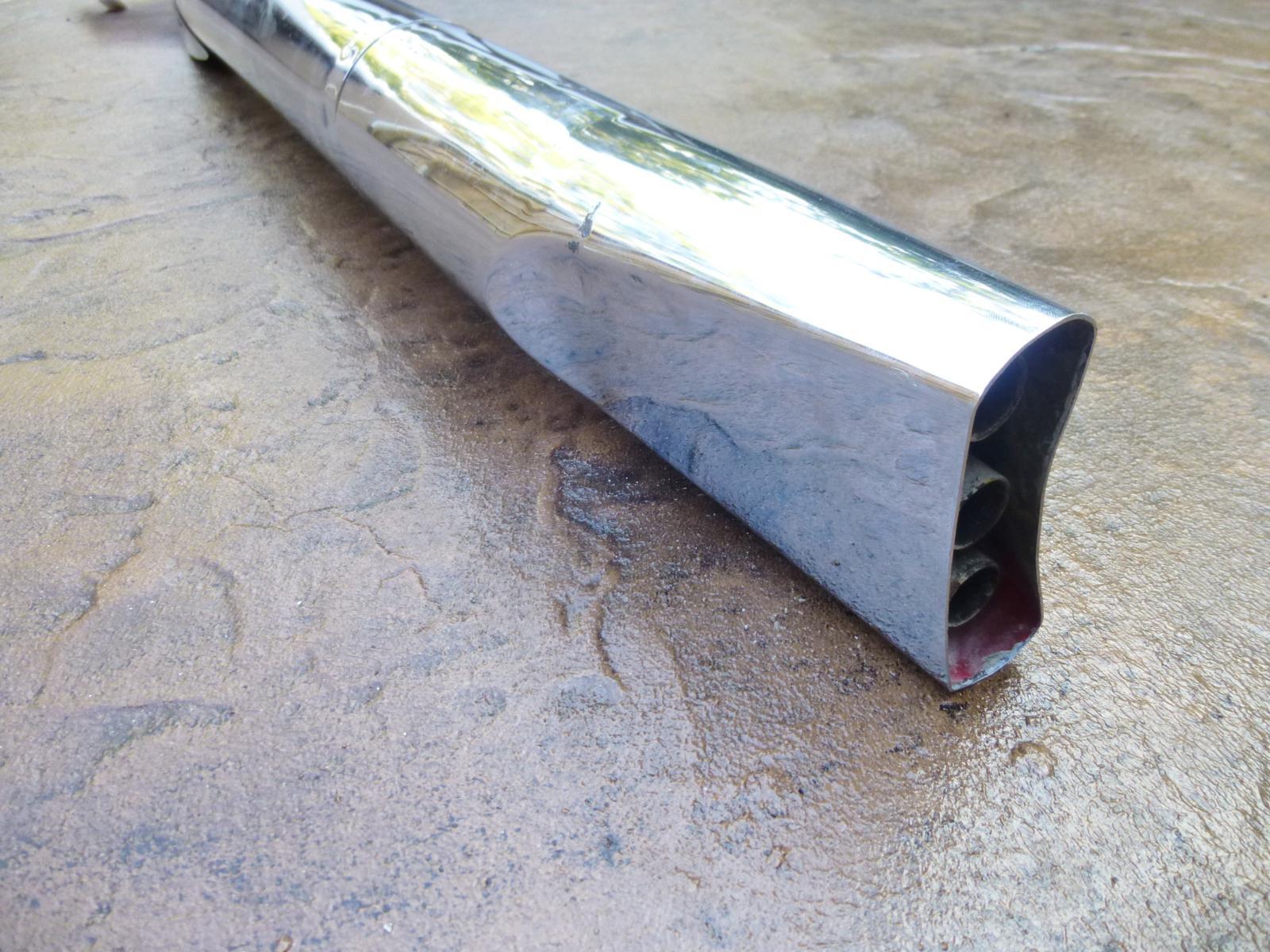

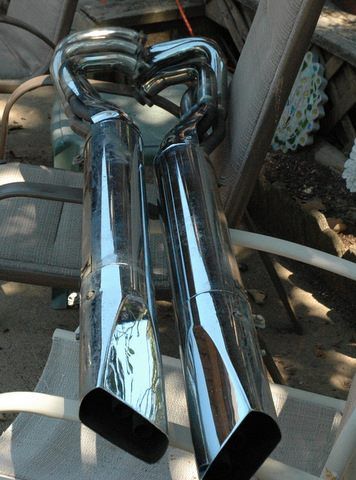

And here are the stock pipes given to me when I picked up the bike:
It is dark inside your mufflers... I can't see your piggies... they're the three pipe-ends you
see here:

The pipes that are on the bike now....appear to be hollow for as far as I can see without a flashlight.

OK, I checked the current pipes on the bike. There is nothing in the area where the "muffler" and baffles would be. Could it be that they are just straight pipes without the "piggies" in there? Of course I had to read around and learn about the "piggies".  Wink

Just went to the shop and checked the other set of pipes that were given to me. Those pipes have the piggies in there and appear to be fully stock pipes.
