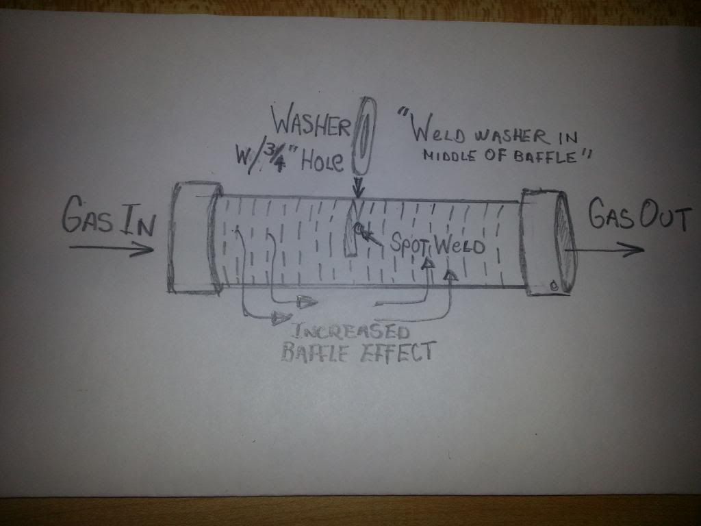

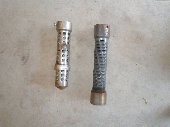

« Reply #18 on: January 22, 2014, 05:50:30 PM »
Hey Ron, Don't remember if I've shared this with ya or not. I've put this out quite a few times. When I had my 6x6's 2qmedic gave me this tip to quiet them down.  Pull the baffle and on the engine side there is a 1" tube sticking out.  Insert a freeze plug in to that tube and either weld or rivet in place.  Then drill a 3/4" hole in the freeze plug (1/2" is too much back pressure) then wrap the baffles if you still need them quieter.  Just keep in mind that the fat girl has a 6 cyl motor which is why its far superior to the BMW....   Evil

« Reply #19 on: January 22, 2014, 06:45:23 PM »
Thanks Youngpup.  Next time I pull the baffles I'll get my spot welder out and try it.  Sounds like it would work pretty good.  I do remember you mentioning this to me before.  Thanks
Here's another idea.  Maybe no hole in washer or 1/2" hole.

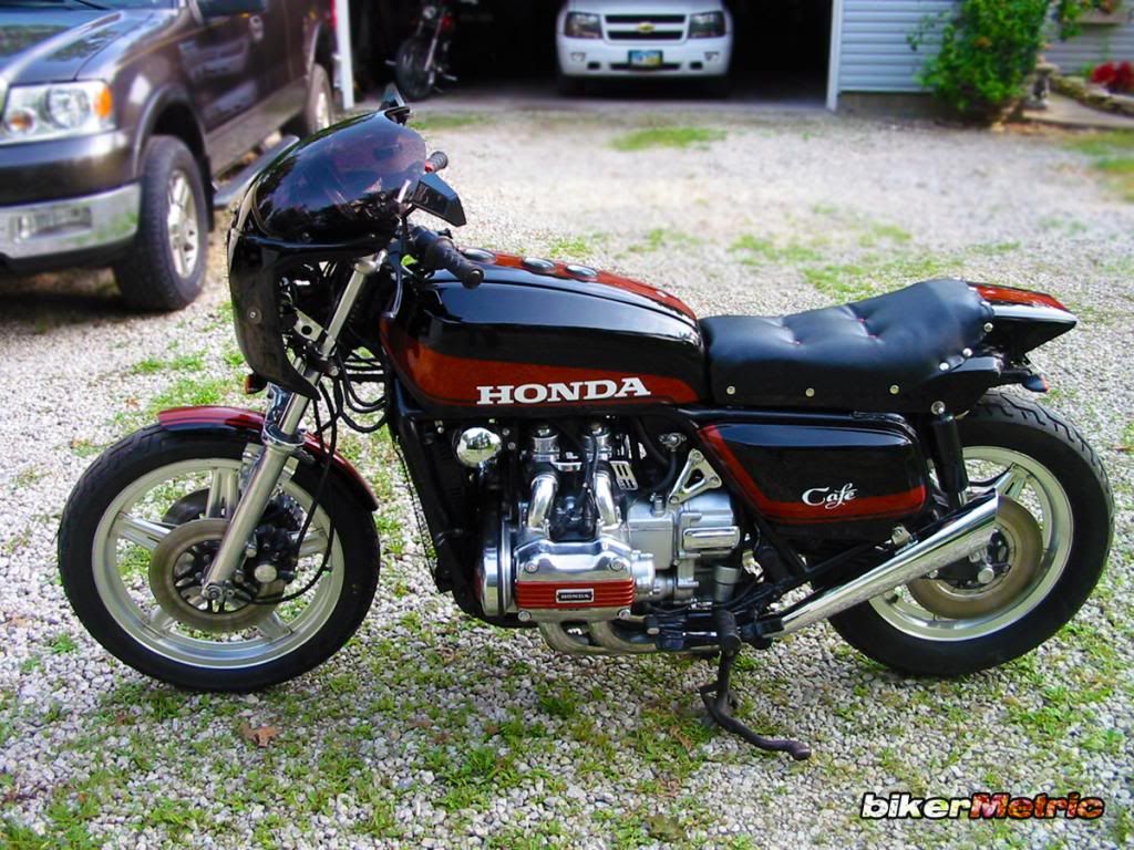

« Reply #22 on: January 23, 2014, 07:31:51 PM »
Not really part of this posting or forum "butt" I bought my "Cafe" bike project today.  I'll show the pic but won't talk about it anymore on VRCC as it's not a Valk although it is smaller similar engine.
'77 Gold Wing, '81 Gold Wing,
Posts: 15411
« Reply #23 on: January 23, 2014, 08:04:16 PM »
Ron, that sure looks prettier than the 1200 I bought last year to restore. It's still scattered all over the garage waiting for parts. Keep us posted on your work, you might want to go on the Naked Gold Wing site. Doesn't cost to join and the old Wings are their only interest. Some great projects and pictures.
Nice...bought an 82 Aspencade a couple of years ago.  Got it all tore down and I'm thinking the engine is shot (luckily didn't pay much for it)...took the side covers off and stuff looks melted.  Haven't decided if I want to part it out or try buying a new engine....

« Reply #34 on: January 27, 2014, 01:14:40 PM »
Hey Ron,
I see brackets there for a set of Krauser bags. Did you get the bags as well? Used to have a set of those on my Suzuki GS650 and loved them. Even the brackets by themselves should be worth a dime or two to someone trying to fix up an old school Wing.
Hello Old_dog!  No he didn't have any bags to go with it.  I'll have to look up some pics of Krauser bags to see what they look like.
