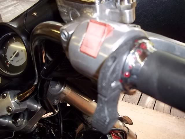

I have the "Brakeaway" brand cruise control and love it! They are a little pricey if you buy a new one, but sometimes if you keep your eyes open, you can find a used one for a reasonable price.

I believe the "Brakeaway" is a throttle lock, not a true cruise control.

If you are OK with a throttle lock, I bought a beauty from MadcoRider.com that I really like. Looks like it came with the Valk. Works great. Well made.

I don't know about beautiful, but here is the least obvious most unobtrusive throttle lock I've ever found!

Brakeaway is the way...very well made and reliable...and yes , it is a throttle lock.

+1  cooldude The best throttle lock IMO is the Brakeaway. I really like the brake release feature in a stop, panic or otherwise. Obviously it can be released by your thumb also.

I agree that the brake-away is a fine throttle lock,especially in an emergency. I managed to pick up a new one really cheap and do like it......however I will be putting a Rostra on my std. this spring/ or sooner if I can locate an inside place to work on it.
