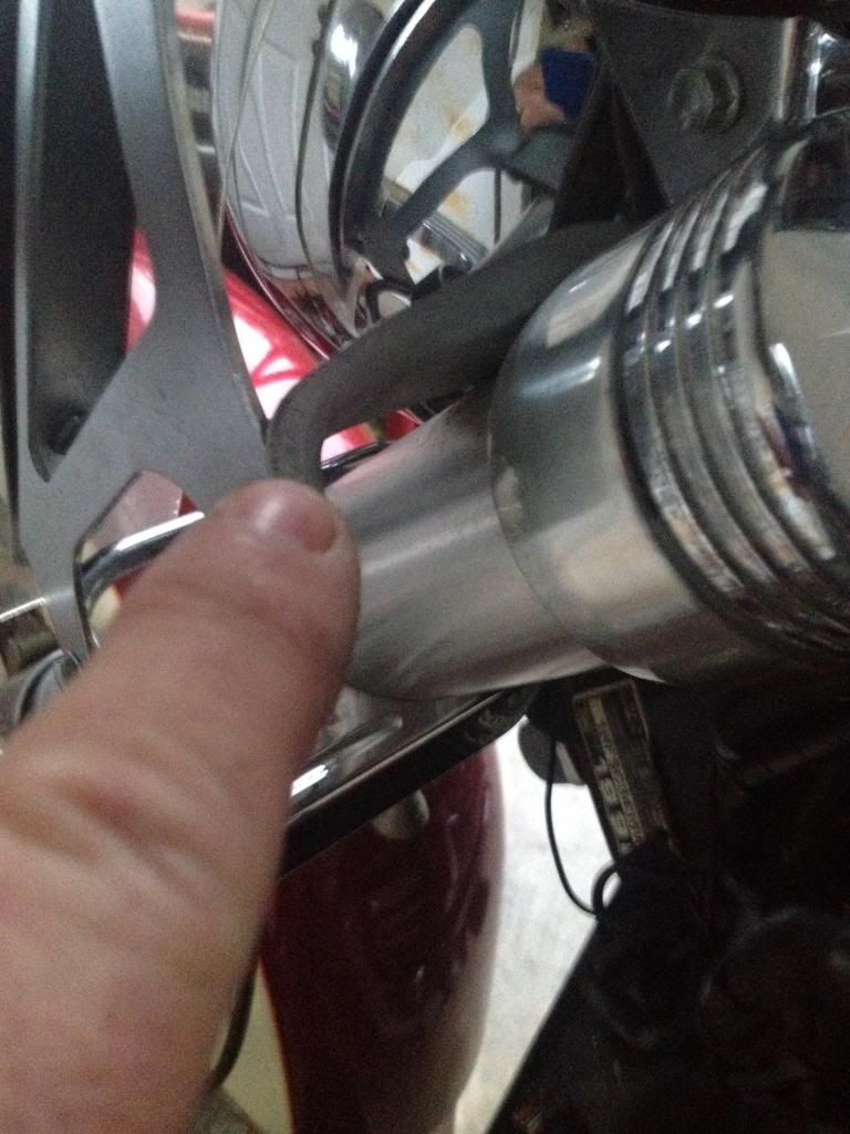

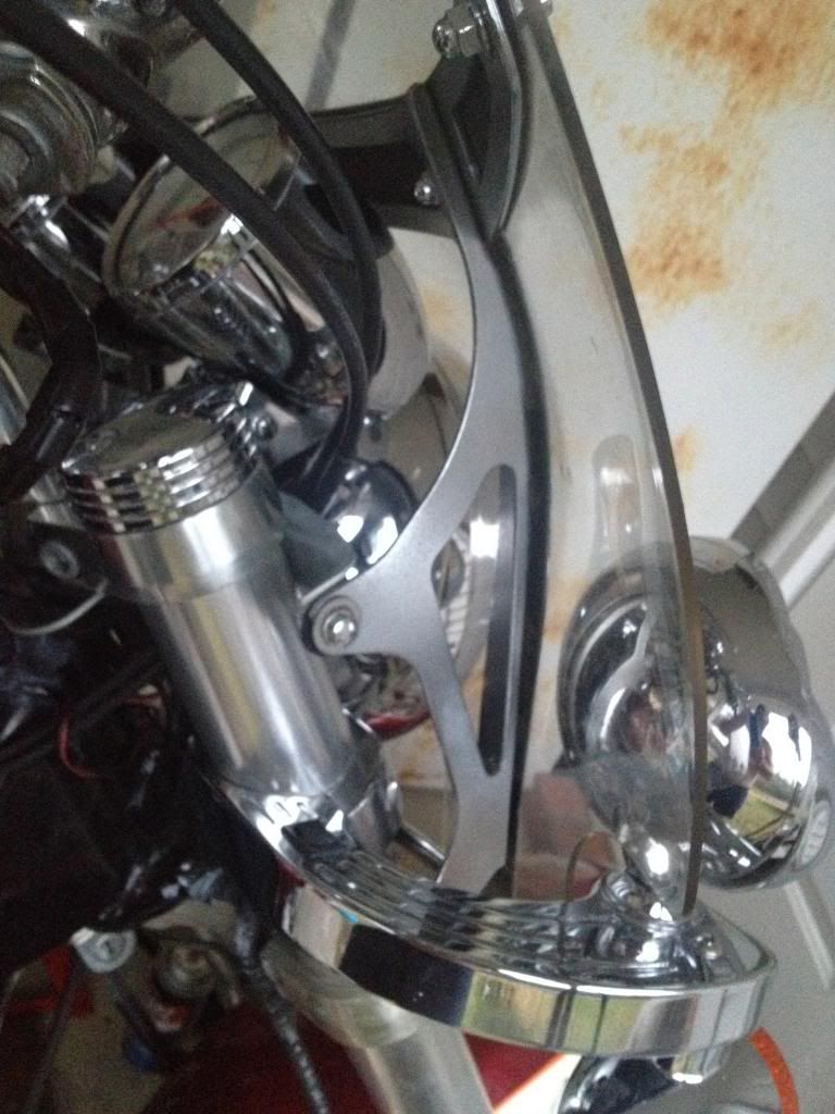

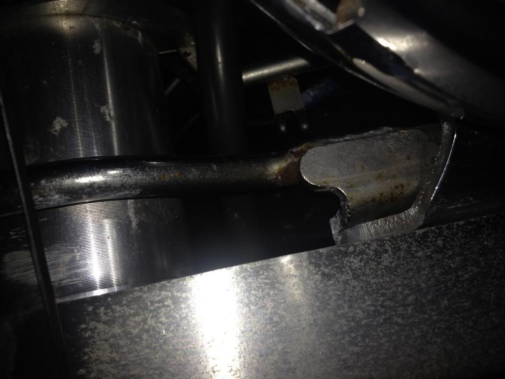

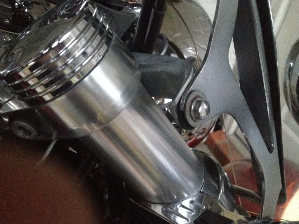

  Here are some pictures of how it mounts on the tourer
top bracket
top bracket meets windshield
This top bracket mounts under top tree
This is bottom bracket
Bottom bracket mounts to bottom tree
   Hopes this helps if you need more pics I will have shelias windshield off to put new screen on today or tomorrow let me know.
  Dennis

« Reply #5 on: March 12, 2014, 04:46:41 PM »
Bigchris99
The top brackets (#3,4) mount under the top triple tree with one bolt each (#18)
The bottom bracket (#2) mounts to the top of the bottom triple tree, over the headlight bracket and is held on with two nuts  (#22)
The windscreen brackets (#13,14) are held to those brackets with an assortment of chrome bolts, spacers &, rubber grommits  (#15, 19, 21)
