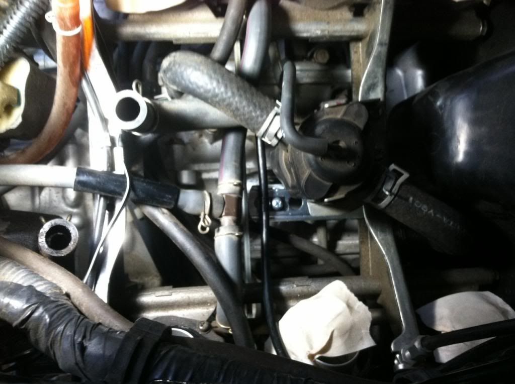

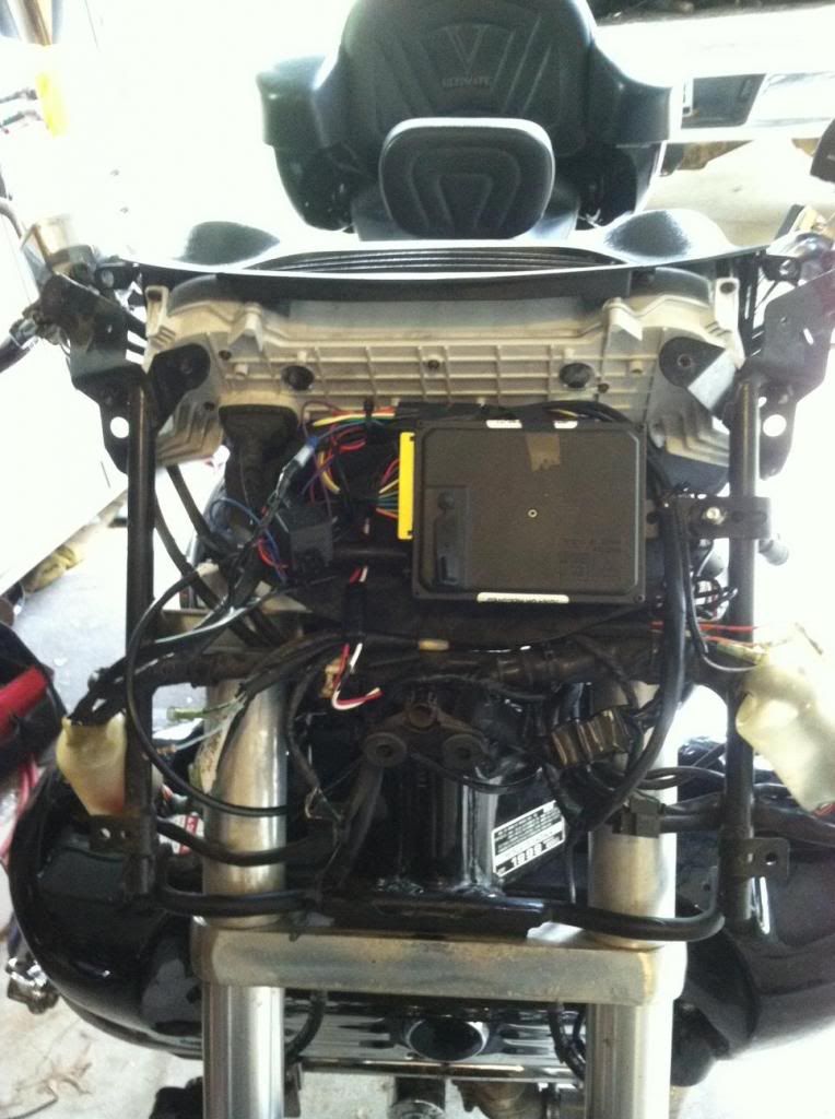

Finally got the Rostra cruise control installed and working. Rode the bike all day today.
Hardware and wiring took some time. My bike is not desmogged so the standard cable hookup did not work. ended  up modifying the brackets that came with the unit. Also used the Audiovox control pad and it appears to have some problems. one of the buttons does not line to work.
Required the use of a normally closed 5 pin and a standard 4 pin relay.
Used yellow green brake wire from the front brake.( to relay for purple brake wire feedback)
Yellow Black from the speed transmitter( Gray wire for speed)
Yellow green in the harness going to the dash for tack. ( Blue wire for tack)
Pink wire from controller goes to on of the relays getting control from an orange wire from the main unit for the engaged light.
All power wires (Brown and red in harness and white from control assembly) Wired to assessory power I had ran up front for my GPS.
I also did the CTS modification and installed a new petcock and air filter while I had the tank pulled.
It took me about 4 rides to get the gain and speed dip switches right.

Since you had everything off you should have gone ahead and desmogged the engine. Gets rid of possible vacuum leaks down the road, which are pretty much guaranteed as the bike ages. And, gives you a lot more room to work with down there.

I ended up with 3, 11-12 down, all others up.
I believe the gain depends on how much slack you've got in your connection to the carb linkage.
I recommend leaving the fairing off and taking the Rostra book, a flashlight and something to move the dip switches on a ride down the highway.   Try different gain settings until you get it set the way you like it.
Been running the electronic Rostra for over 4 years now and works like a champ.
