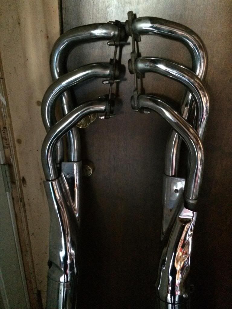

I just ordered a set of Mark T pipes so I want to get a jump on the project.  As I read on the board here, there have been many different experiences.
On the left side, 5 of the 6 studs came out with the nuts.  On the right, only one came out.
Is that normal?
Secondly, has the debate been decided on what to use when installing new studs?  Anti seize, Loctite, etc.?
Any help or insight would be appreciated!

If none of them broke, you're ahead of the game.
I took my exhausts off numerous times when I first got my Valk,
no studs ever came out or broke... No telling what would happen
now, 60,000 miles later...
« Reply #2 on: April 18, 2014, 08:33:34 PM »
Its probably a good thing the studs came out. Dont want to break them off. I would use some high temp anti seize on the studs and put them back in.
