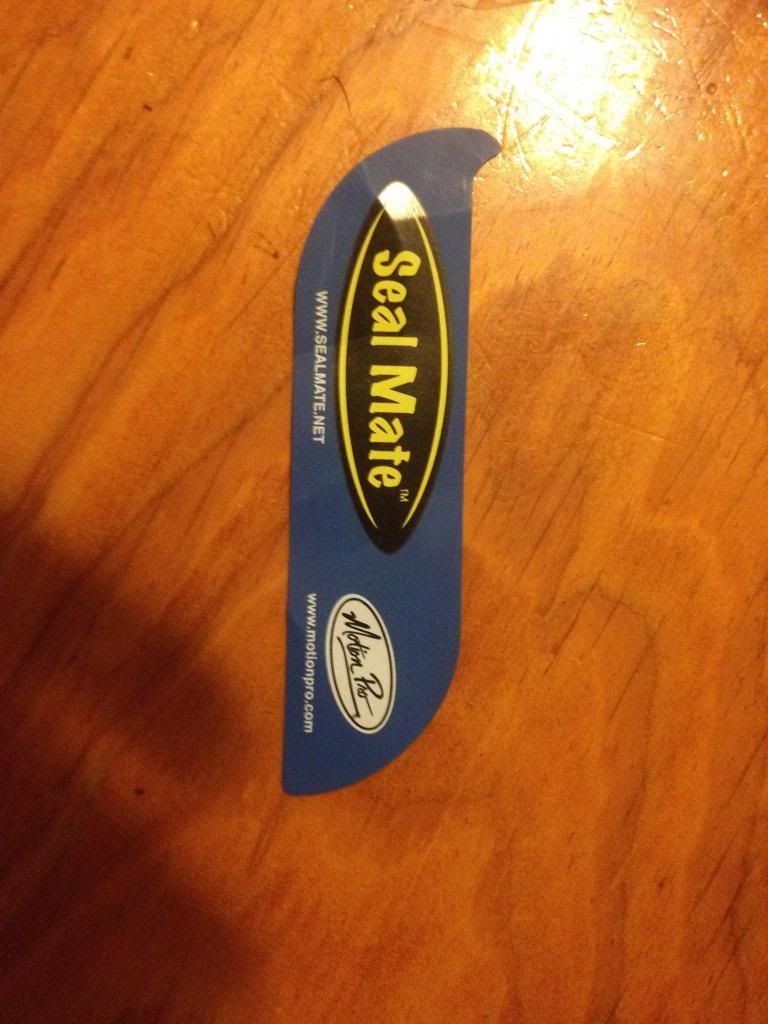

Bill try the seam mate worked for me a bunch of times on different bikes.

+1 on the Seal Mate.  Just used it for the first time last week and I no longer see a leak (about 100 miles since the repair).
I have no opinions or responses to your original questions regarding the best place to buy seals, whether to buy OEM, or the left rear shock nut.
Prior to using the Seal Mate, I did wrap a small strip of cloth around the fork to prevent the leaking oil from getting on the rotor, wheel, and tire.  It was a pretty slow leak.

It doesn't take much fluid to leak to make a big mess. You probably only need be concerned about fluid getting onto the brake pads. If you pull the forks and carry them into the dealer, labor is the most expensive part. I went with OEM parts when I did mine. If the sealmate or similar works to stop the leak, you most likely did not lose enough fluid to affect handling cooldude

my right fork was leaking, for 1 day, now nothing. I starting to think there really is something about the air pressure buildup in inverted forks
Posts: 30875
« Reply #12 on: May 22, 2014, 10:35:10 AM »
Perhaps, but I think it is more a function of temperature changes (expand/contract), and (assuming a seal is not torn/damaged, so leak would be continuous) as the sliders bounce up and down, whatever crud is causing the leak gets moved around, so sometimes it leaks and sometimes it doesn't.
When I use the seal mate, I am never able to actually see any solids being cleaned out, and I think it more likely I am just shoving the crud farther up inside above the seals than cleaning it out.  Or some of both.  I think that is why my forks will stay dry for long periods, then begin to get wet again, as the crud works it's way back down again.

Maybe I should start with $8.99 for Seal Mate and see how that does?

I would think OEM = Honda seals?  At any rate the seal mate worked for me  cooldude – I had one fork seal leaking pretty bad in the winter, but one of those things on eBay for five bucks, and it cured the problem... At least for the season I would think.
