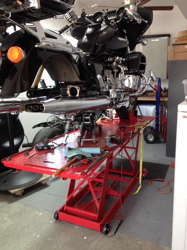

« Reply #5 on: June 04, 2014, 04:42:42 PM »
I am really enjoying the Harbor Freight lift my wife got me for my birthday in May. Seems to work well and I love the fact that I don't have to bend over to do everything (like I have to with Uncle Sam).Paid $299 for it with a coupon.

« Reply #11 on: June 06, 2014, 10:02:06 AM »
I'd love to see some more pics (the more the better) of your Valk, or Valks up on that Harbor Freight table lift.   cooldude

« Reply #13 on: June 07, 2014, 11:59:08 AM »
I have the red and black craftsman lift and have not used it after I got the HF lift table. I was never comfortable leaving the bike on the craftsman lift for any length of time so I bought the lift table and been very happy with it. If I don't have time to work on it I just leave it there.
