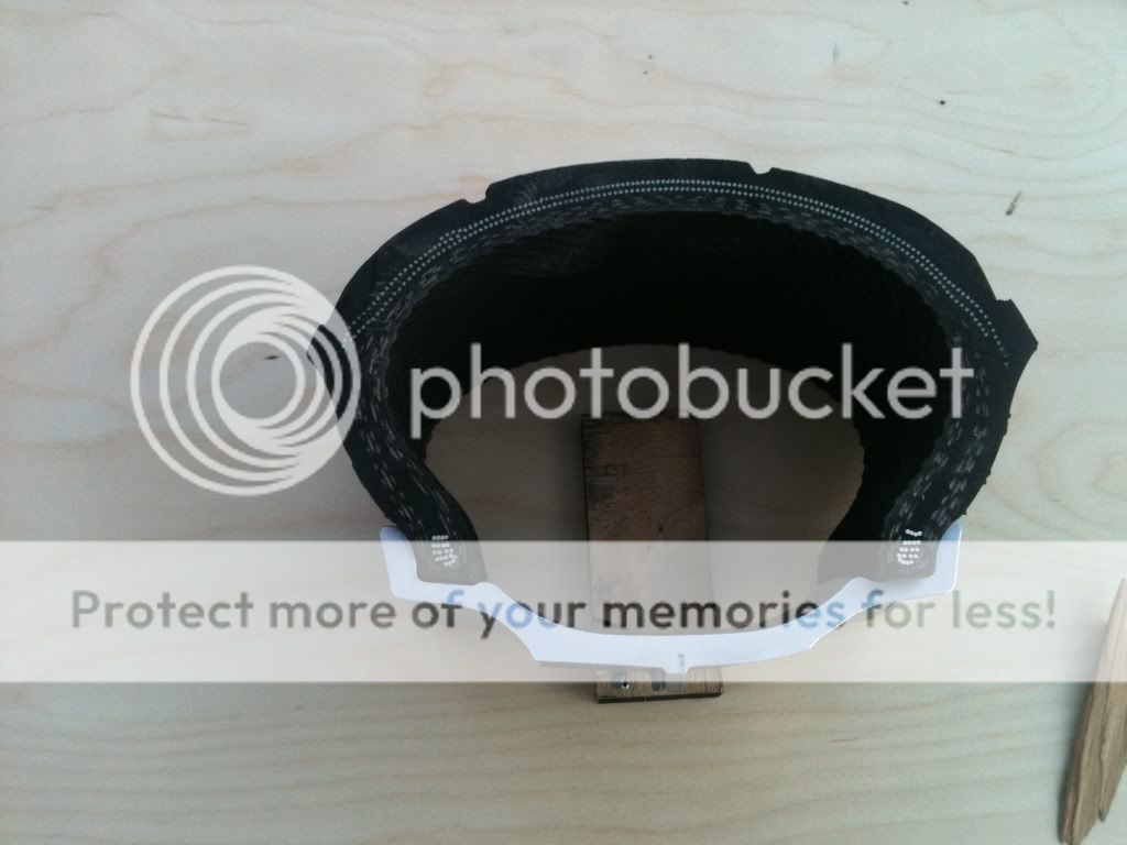

Well, I've only mounted one car tire and no motorcycle tires on my Valk rim myself, and, yes, it was difficult.  Someone cut up a car tire, a motorcycle tire, and, I think, a GoldWing rim and took pictures to prove his point about the unsuitability of car tires on motorcycle rims.  I'll show them for my purpose of illustrating and comparing sidewall thicknesses.

OK, definitely more material in the bike tire sidewall.
« Reply #13 on: July 15, 2014, 02:12:41 PM »
Well, that makes sense, but regular all season radial car tires still have to work with 3K+ pound cars pulling hard Gs thru turns.  If air only carries the weight, then sidewall CT stiffness must be regulated by how much air you carry in them.  So if they are wobbly, they must need more air.  And they aren't exactly easy to spoon on a rim by hand.
Cool pics G.R. I'm curious how they show they prove his point that the car tire is unsuitable. Looked good to me.
You asked for it; happy reading!
http://www.goldwingfacts.com/forums/10-reference-faq-forum/400426-design-differences-between-car-motorcycle-rim-tire.html
« Reply #15 on: July 15, 2014, 04:28:12 PM »
Man that was about 95% over my head  Shocked

« Reply #16 on: July 15, 2014, 07:54:44 PM »
Don't worry about it meathead!
The sidewalls in my Vredestrian are a lot thinner than that tire shows. Of course it is an Ultra High Perf tire so that may make a difference. Would be wrong to assume all car tires have sidewalls like that one.  The thought behind the thinner sidewalls is to allow the tire more flex so it can keep more tread on the ground during hard cornering in a car.
