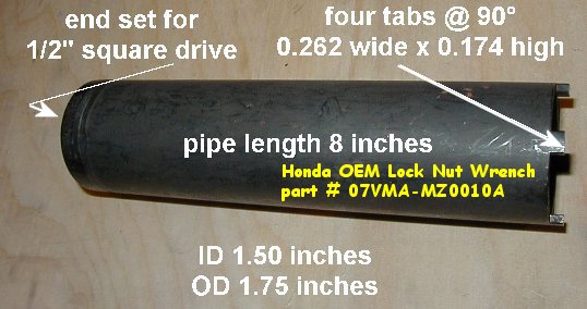

This is the tool required to change the fork springs on an Interstate.

an electric heater element wrench is the same ID and OD needed. just need to notch the round end to work. large socket other end for torque wrench.

here are the dimensions of the honda tool.
http://rattlebars.com/vtx/forktools.html

found my org post from '06
Posted By: 98valk <fitness7days@nospam.juno.com>
Date: 6/26/2006 at 05:30:06
In Response To: any fork tools in rockhill area (draino)
u can use an electric heater element removal tool from home depot for $6, it has the required ID and ODs. Modify the round end per Chet's website http://www.rattlebars.com/vtx/forktools.html
and u will need a 6 point 1 3/4" socket and 2-3 large washers to fit inside of the socket. The washers are to keep the socket from hitting the triple clamp while pressing down to remove the inner fork nut. It will also be easier to remove if a 2x4 is put under the front wheel and then lower the bike which raises the inner nut whereas the washers are not needed.

Well 44mm equals slightly under 1 3/4" @ 1.732.

« Reply #9 on: April 11, 2021, 10:48:55 AM »
Check out this link for some good info on changing fork springs. It could prove helpful for changing seals and oil as well.
http://www.valkyrienorway.com/forksprings.html
Also this is a pic from the Rattlebars linked document. I have the document saved, but the link is no longer good. This shows the dimensions of the "locknut" tool.

« Reply #10 on: April 12, 2021, 04:01:12 AM »
My homemade tool is 42mm (1.65) O.D., thick wall pipe, built to somebody's spec. that I found on here?, said it worked just fine. I could not find any pipe with 1.75 O.D. I have not used it yet to verify how good it works.

« Reply #12 on: April 12, 2021, 06:32:25 AM »
Also just to be clear to folks that may not know...this tool is only needed if you are changing out the actual springs (and only then on one side). It is not required if you are just doing a seal/bushing change.

« Reply #13 on: April 17, 2021, 11:11:10 AM »
Tools I used to change my triple trees, fork springs & consumables.  Made the spanner in the middle.
