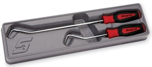

Hose Pick! Cheap tool when used right will allow you to remove the hoses without using bad words.
The hose pick and A little white lube will also help get the hoses back on easier just make sure you put the hose clamps back on the hoses before you slip the water pump in place.

Where get hose pick from
Tool store or auto part store or craftsman store or snap-on truck or Mac tool truck something like that.

Sorry I posted from my iphone and it didn't all show up.
I think I got my cheap set from harbor freight and my good set at work from sears.
after you loosen the clamp you gently insert the hose pick between the hose and water pump and gently work it around the hose this will break the seal between the hose and pump and allow the hose to slip off easier. you can also use it to help slip the hose back on.
