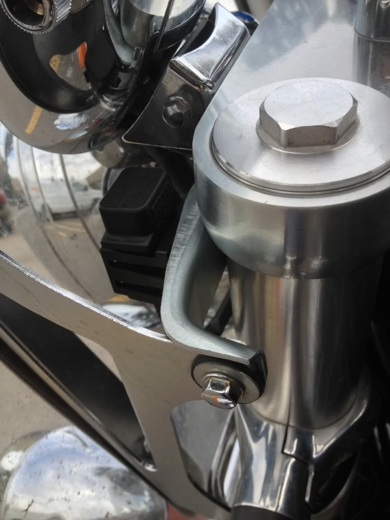

There are at least a couple of, and possibly more, manufacturers of USB charging ports with weatherproof caps for mounting on motorcycles.  Here are two:
http://www.burnsmoto.com/
http://www.3brpowersports.com/
I have the 3BR Powersports TAPP Lite 1.2A charger mounted near my handlebars where I can plug in my iPhone. I have it wired to the accessory circuit which is only on with the key.  It is held on with the double-sided foam tape that came with it, and it has stayed put for the one year I've had it. If I were to do it again I would get the 2.1A version because it doesn't charge my phone quite as fast as I'd like it to. Here's where I put it:
