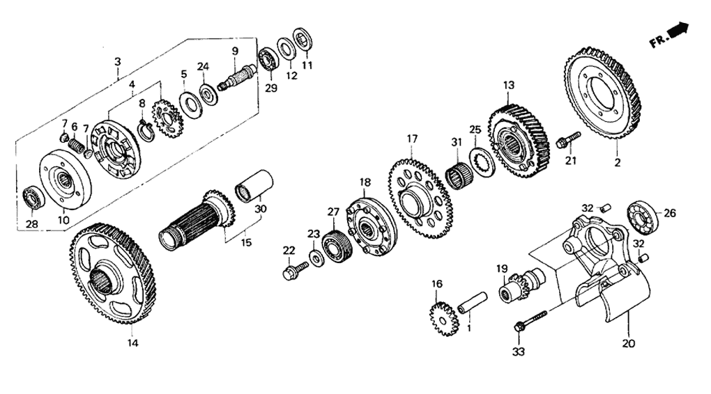

« Reply #2 on: August 10, 2014, 08:42:00 PM »
Please verify yourself, but this is what I think is correct.
http://www.bikebandit.com/1999-honda-valkyrie-interstate-gl1500cf/o/m151389#sch304798
Item 16 & 19.

« Reply #3 on: August 10, 2014, 09:22:29 PM »
When I had my Hydrolock, I only needed #16 but sometimes you also need #19 or even the rear case.

« Reply #4 on: August 11, 2014, 05:47:30 AM »
Looks to be just #16 but went ahead and ordered 16,17 and 19 just in case. We're pulling the motor this week and will get a better look inside. It still starts but sounds like a can of marbles. After starting it runs smooth and has all kinds of power. Just this stupid hydro lock issue.

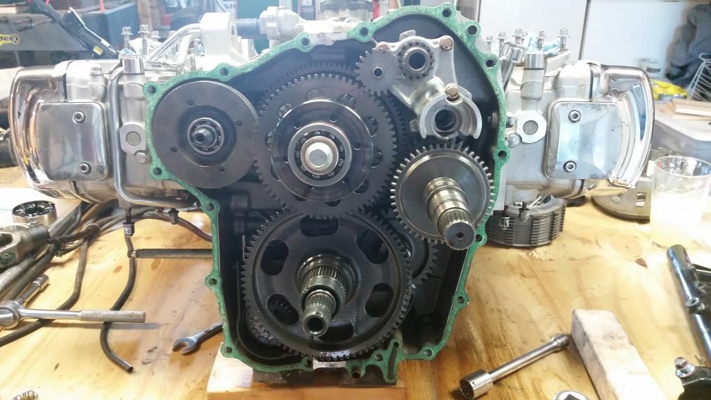

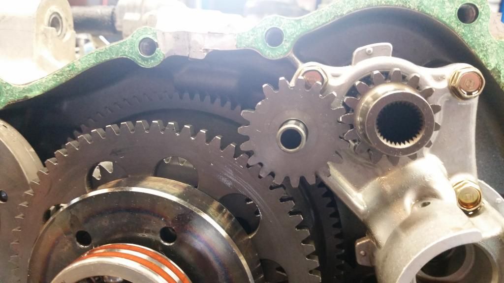

« Reply #13 on: August 12, 2014, 07:02:01 PM »
Just a couple pictures of the rear case apart and the broken gear.
« Last Edit: August 12, 2014, 07:04:52 PM by Gavin_Sons » Logged

« Reply #15 on: August 12, 2014, 07:18:59 PM »
Awesome thanks Gavin

« Reply #16 on: August 12, 2014, 07:37:56 PM »
Not a problem. Our new gear and gaskets should be here friday and we will start piecing it back together. Hopefully have it running and on the road again early next week. We went ahead and desmoged it while the motor is out. Makes it a lot easier. I made a couple sockets to fit the lock nuts inside the cases today at work. One was 1 7/16 which fits the output shaft lock nut and the other was a 1 13/16 which fits the clutch basket lock nut. I know everything is metric but it is what I had at work. Cut the back off both sockets, welded a piece of pipe between the 2 pieces and used my 1/2 inch impact to remove the nuts. ill post a picture of my sockets in a few.

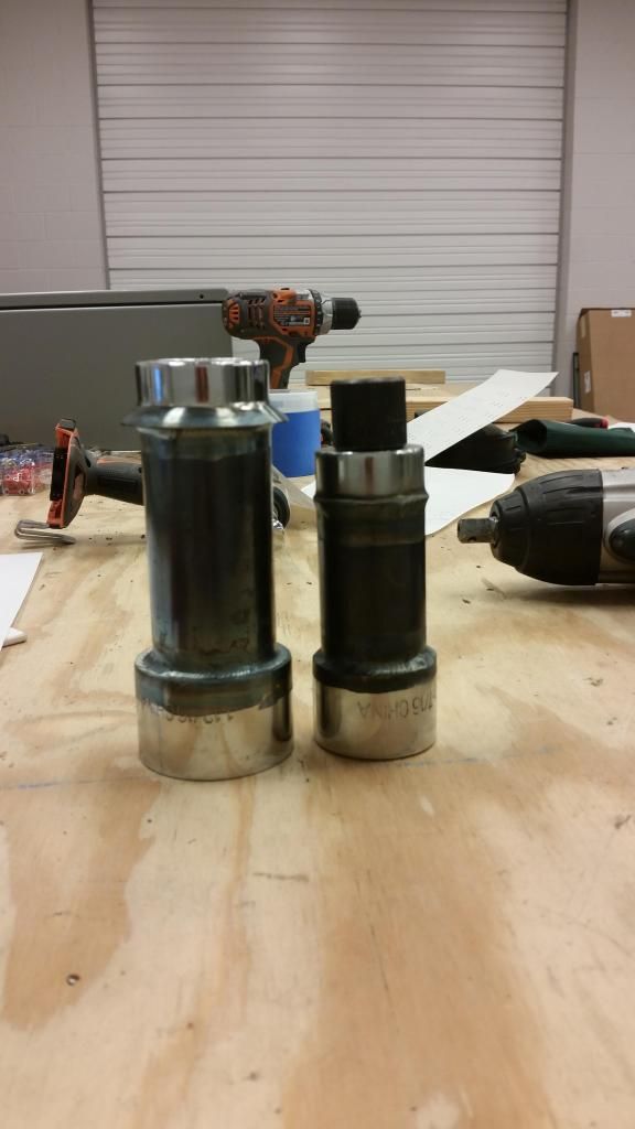

DK
Posts: 616
Little Rock
« Reply #25 on: November 06, 2014, 06:39:17 AM »
I'm new to the forum and Valkyries to a lesser extent and was not aware that a hydro lock could do this damage until reading this post. I had assumed the starter would just lock up and that it might be necessary to change the oil if an overfill occurred.
Would it be possibly / adviseable/ safe to install a default-off solenoid valve and / or a fuel filter in the fuel line? It seems that doing this might minimize the problem.
I shudder to think of having to do this repair four times.
