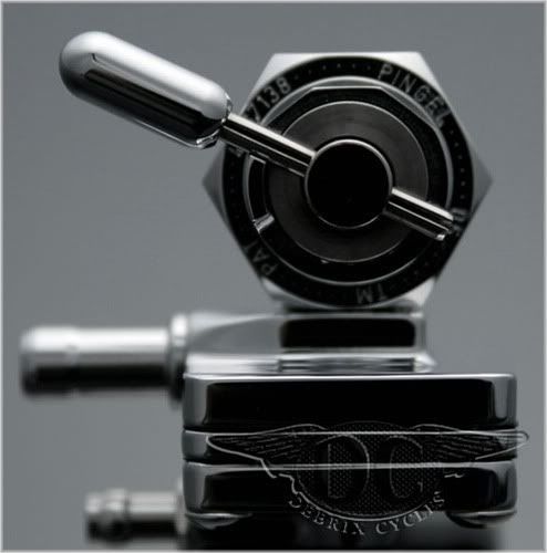

Are you sure you are not turning it to the off position thinking it's reserve? On my 1311 pingle with access on the left side, all the way forward is off, middle is reserve, and all the way back is main tank capacity minus reserve.

« Reply #15 on: August 31, 2014, 05:39:45 AM »
Maybe this pic can help. This position is off, as Tom points out. My (vacuum) ping has worked fine since installation. Wish it had detents but other than that its fine.
