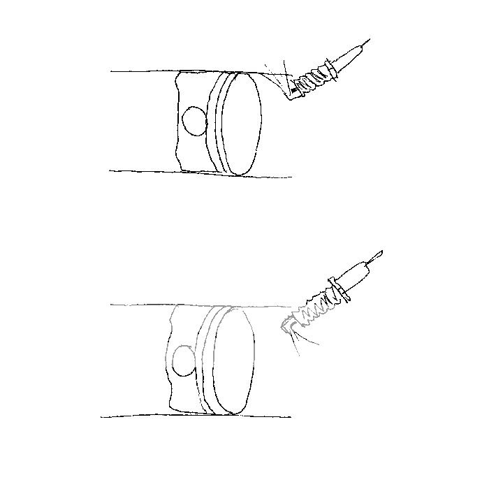

« Reply #4 on: November 17, 2014, 10:16:59 AM »
Well you can always get a couple dozen spark
plugs and index them.  They're still doing it
at the drags and Nascar. It ought to yield
comparative results to using those $20 plugs.
2000_Valkyrie_Interstate
Posts: 14887
« Reply #5 on: November 17, 2014, 11:41:57 AM »
I have pretty good luck indexing with just 6 or 7 plugs.  It doesn't have to be perfect to give good results.  Basically quicker starting and smoother idle.  Id like to say 8-10 hp increase, but that would be a lie.
N0tac0p
Posts: 413
« Reply #6 on: November 17, 2014, 12:25:14 PM »
indexing plugs?
Posts: 14887
« Reply #7 on: November 17, 2014, 12:32:30 PM »
indexing plugs?
Its a process of getting the spray aimed at the center of the chamber (nearer to the intake valve) instead of at the wall.  You have to get the plug to stop at the right place.  I do it by juggling plugs.  They sell indexing rings that help you to more accurately adjust where they stop.
Ricky-D
Posts: 5031
South Carolina midlands
« Reply #8 on: November 17, 2014, 01:59:49 PM »
There's plenty on the web about indexing plugs.
Here's one:
https://www.youtube.com/watch?v=Ys4GnIk_YC0
