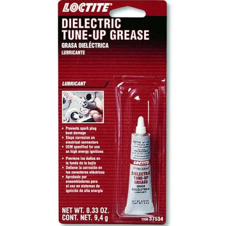

get a little razor knife (exacto type) and clean the slot the little brass contact rides in, you need it free to bounce up and down on its spring, then put it back together with a little dilactic grease and it should be good for a long time

Gordonv: It was a new starter switch assembly I purchased.  Update:  It started up all day the other day, I drove it to work two days later (today) it didn't start!! just that clicking noise, To recap I load tested my new battery, the starter switch is new, I have a new starter relay, I checked all wires in the headlight area for bad connections, I'm not sure what else to do, I have torn acl's on both knees but managed to push start it to get home, I got home and turn it off then back on about 3 different times and it started up just fine!!  Is there a faulty wire I might of missed? Or could it be the starter?
I also put that electronic grease on my starter switch area.

Did you check the contact on that new switch to make sure its not stick in its slot?  If it cant bounce up and down on its spring it will fail after a short time because it gets pushed down.
