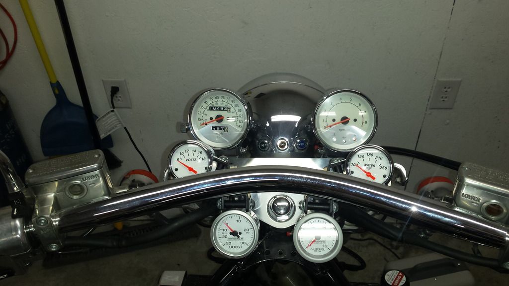

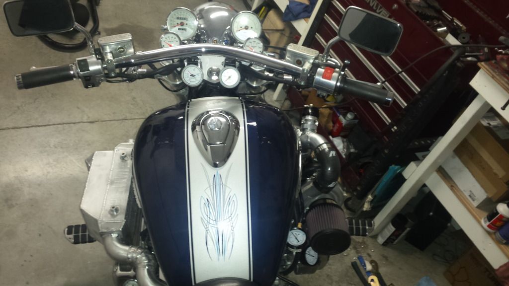

« Reply #80 on: March 15, 2015, 08:28:24 PM »
Here are the Voltmeter and Water Temperature gauges....

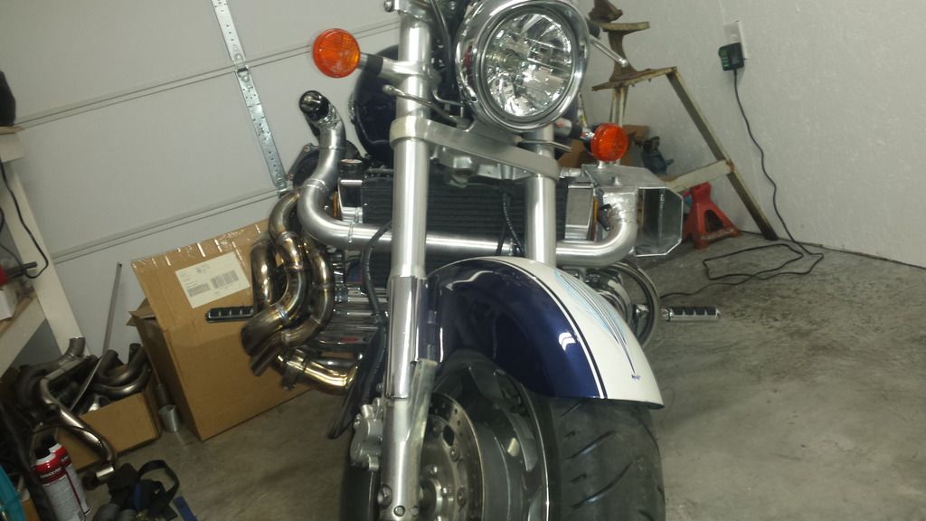

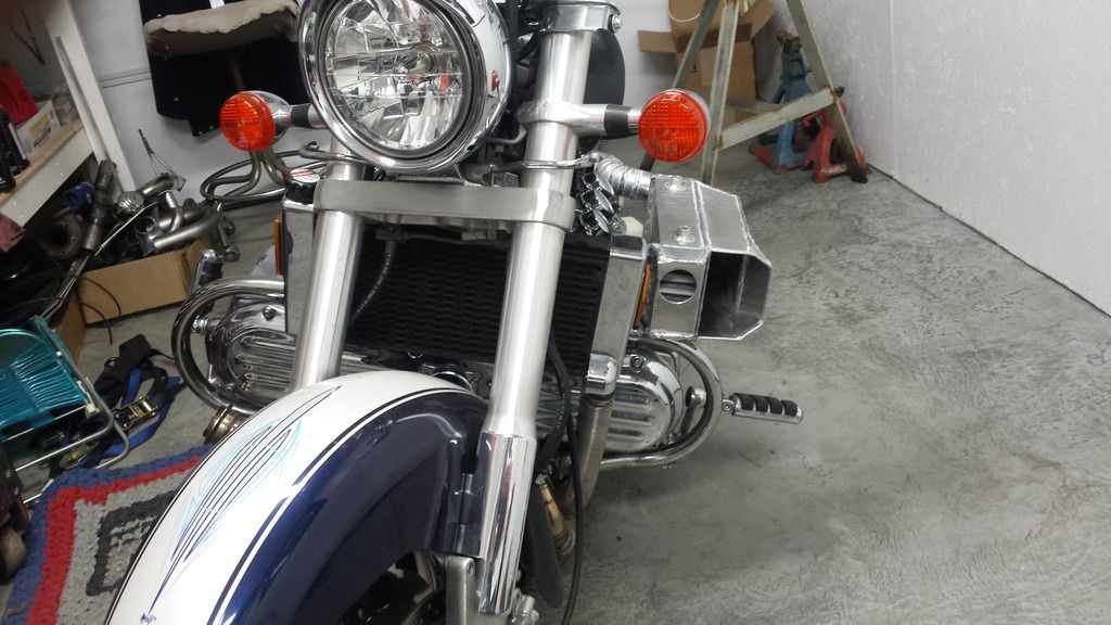

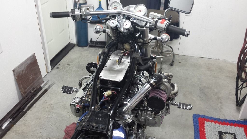

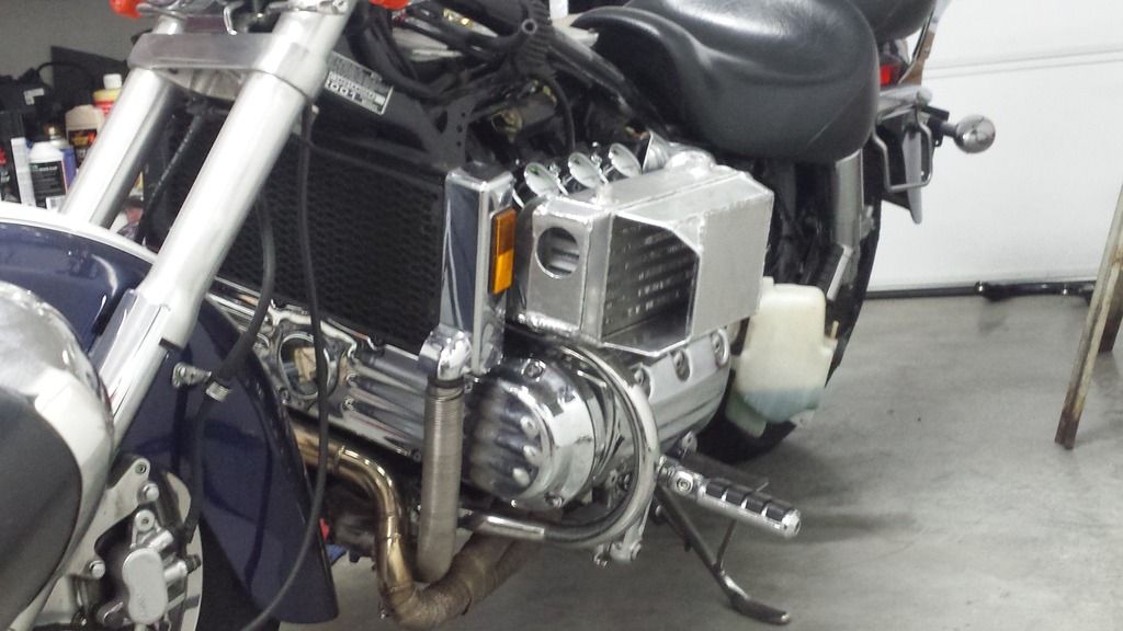

« Reply #81 on: March 15, 2015, 08:33:43 PM »

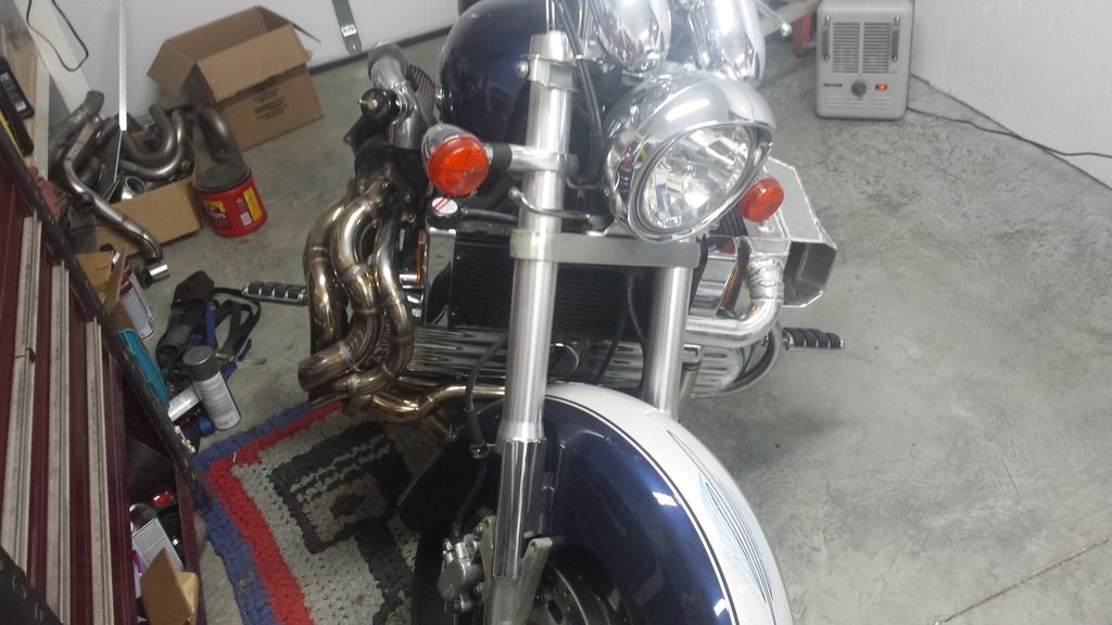

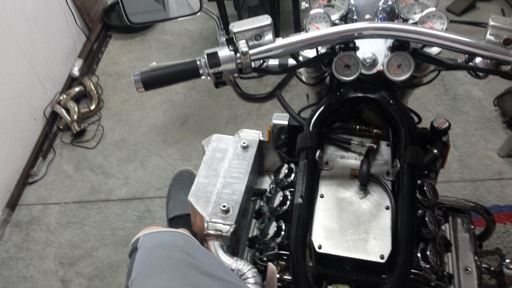

intercooler added but not completely plumbed in yet, and I did not have to modify the plenum for this...

moodyvalk
Posts: 150
SE Kansas, NE Oklahoma
« Reply #82 on: March 15, 2015, 08:36:10 PM »
almost got the plumbing done on the intercooler....

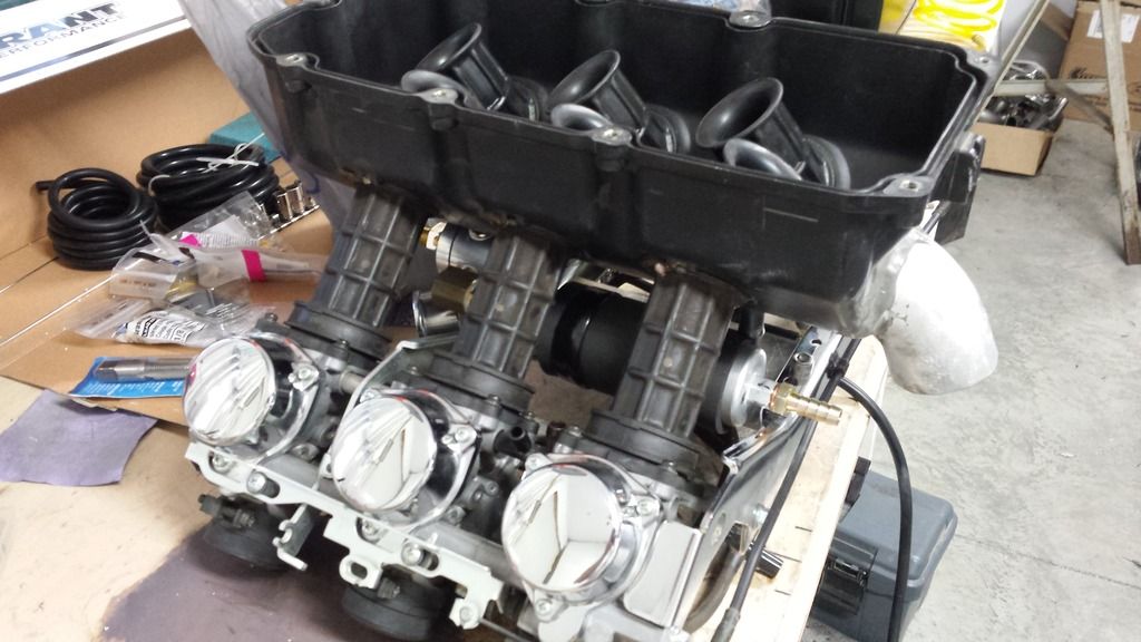

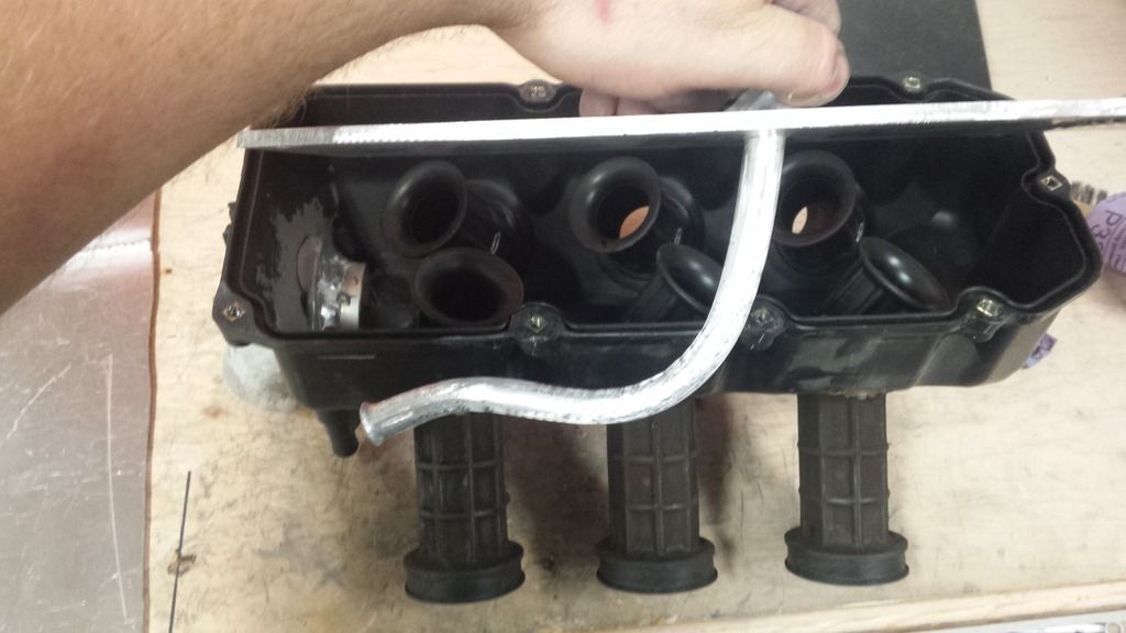

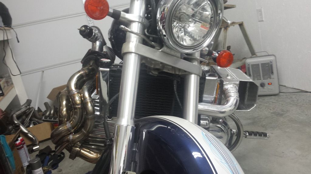

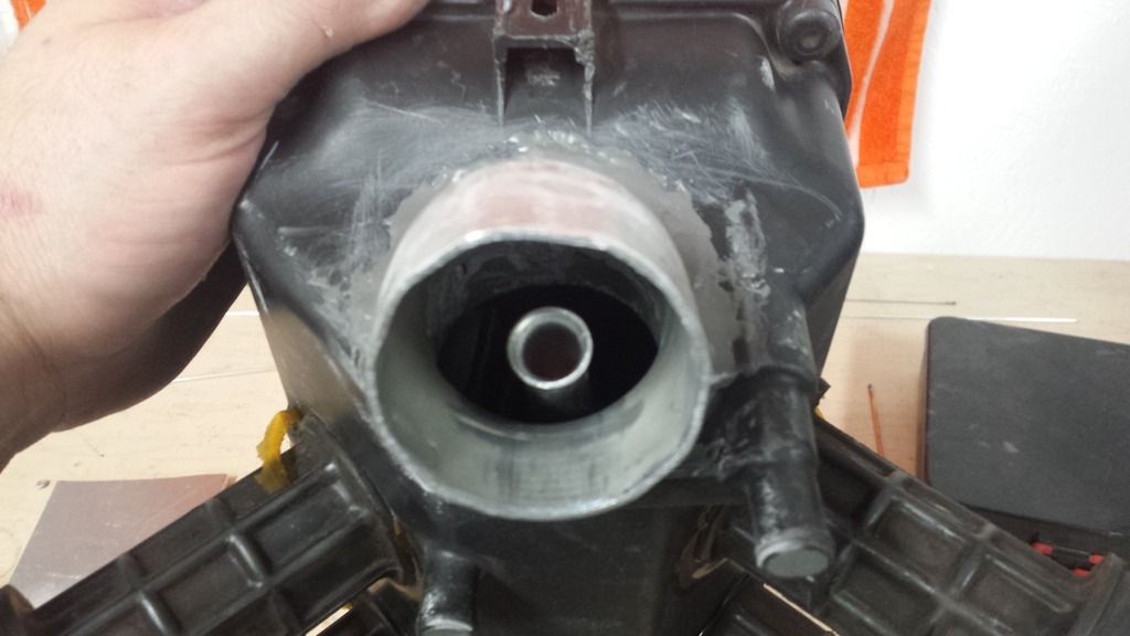

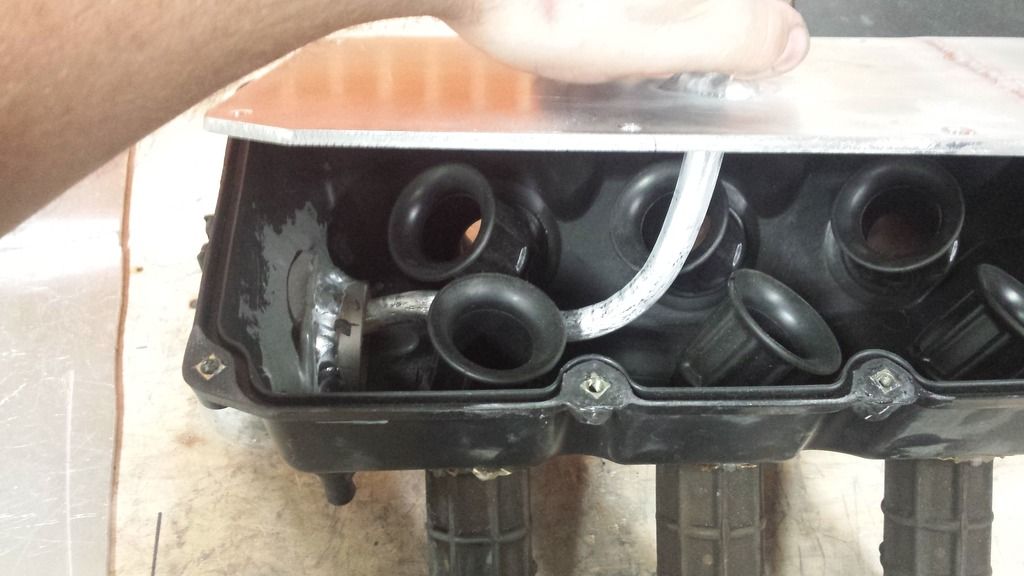

« Reply #83 on: March 15, 2015, 08:40:26 PM »
the requested plenum pics...

moodyvalk
Posts: 150

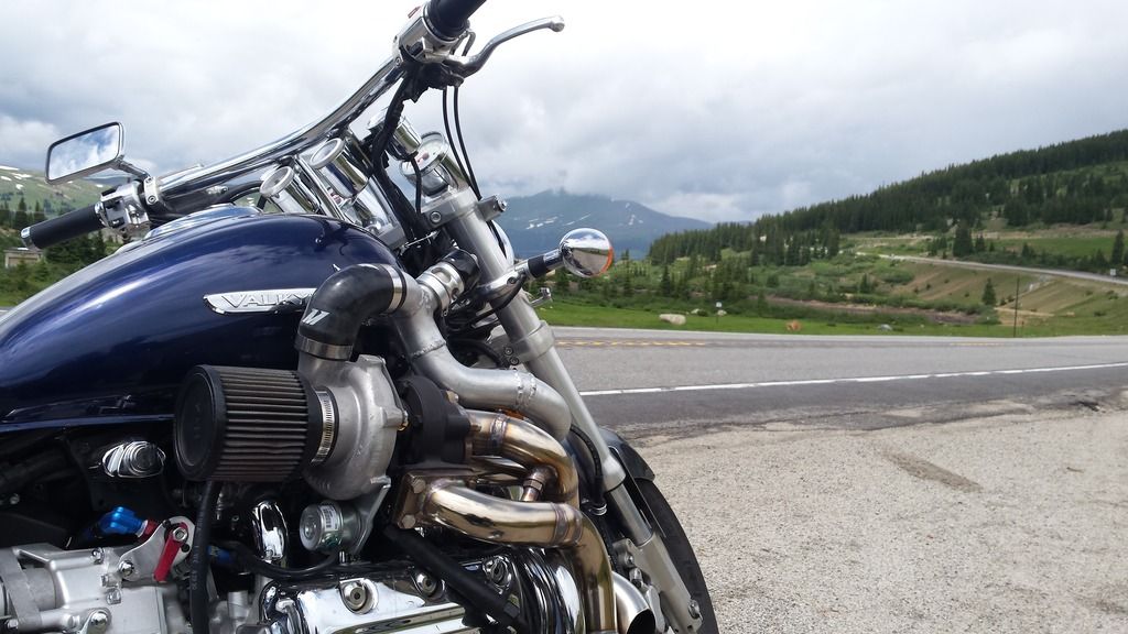

« Reply #84 on: March 29, 2015, 12:44:02 AM »
new charge tube and intercooler plumbing done.  I want with a brushed aluminum finish versus polished tubing....

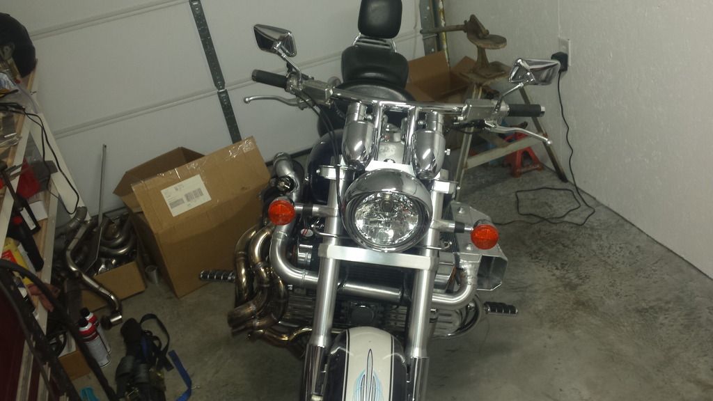

moodyvalk
Posts: 150
« Reply #85 on: March 29, 2015, 12:46:40 AM »
couple more....

« Reply #88 on: March 29, 2015, 03:10:03 PM »
hey moody.. where did you get the water temp guage from?

« Reply #89 on: March 29, 2015, 03:41:25 PM »
its an Autometer brand gauge...I ordered through www.summitracing.com

« Reply #90 on: March 29, 2015, 03:50:50 PM »
Thanks! did you hook it up at  the sending unit on the bottom of the radiator?

« Reply #92 on: March 29, 2015, 04:02:51 PM »
I drilled and tapped the boss on the thermostat housing.  very clean and easy install on the bike, although you do have to remove the thermostat.  so I recommend replacing the t-stat seal and not reusing it....

I do think the turbo valk will walk away from a stock wheel base hayabusa (naturally aspirated).
about a month ago I finished a turbo build on a gen 2 hayabusa, stock wheel base and tuned all the ignition maps and boost fueling through the factory ecu by reflashing it.  the software was pretty cool cause of the autotune feature.  and yes the stock wheel base busa at 8 psi of boost if a handful to say the least!!!!
here is a pic from our 600 mile ride up in the rockies, pic includes the turbo valk, the recent turbo busa, and my harley vrod muscle

« Reply #113 on: July 16, 2015, 11:18:48 AM »
Sure looks different without the pipes.
RonW
Posts: 1867
Newport Beach
« Reply #114 on: July 17, 2015, 01:07:33 AM »
yea, different as in *wicked*.
