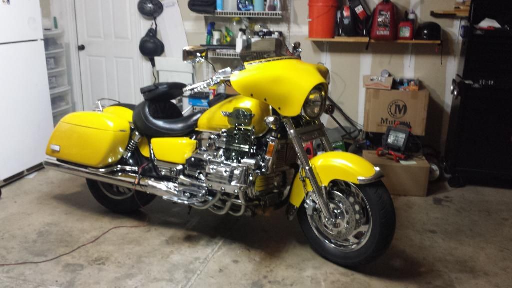

Before you commit to the Memphis Shades Batwing fairing, you might want to take a look at the Woodys fairing.
It's handmade from fiberglass (not plastic like the MS), one at a time specific to our Valkyries.
http://www.woodysfairings.com/fairingsetc/HNFVLKX.html
I love mine.
I love mine.

« Reply #9 on: January 01, 2015, 05:26:20 PM »

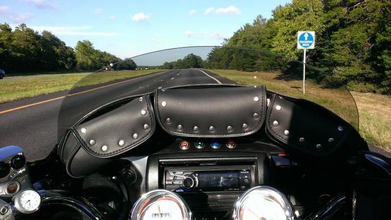

BF, that fairing really looks good! I really want to put a fairing on my '97 Standard. From what I read on here, the "Woody" is the way to go. I've been to the Woody web site a number of times. I like what I see and read.
  What windshield did you go with. I like how it curves up. Do you get good protection from it. Install easy enough? Any info and tips will be appreciated!
   That's a beautiful girl you have their!
The one you see in that pic is a 7" with re-curve.
The re-curve does give extra protection as opposed to a shield with out it.....like adding an extra 2 inches or so.
Install is a breeze.  You can change out windshields literally in less than a couple minutes.  Just loosen the three mounting bolts/nuts (don't take them out....just loosen them some), slide out the old shield, slide in the new shield, tighten the three bolts/nuts....insto presto....changed shields.
When I first ordered my Woodys and talked to Glenn, he told me that a 10" shield is the closest to the OEM windshield....which is what I had on the bike before.  I looked just over the OEM.  It's the same with the 10" shield for me.
A basic/straight (without re-curve) shield is what I ordered with the Woodys (in light tint).  It was pretty good, but I got a tad of buffeting with it....the same as I did with the OEM shield.
I've since bought a bunch of shields to try out.  I have that original 10" straight shield....and I have a 4" basic straight shield in solid black, a 6" with re-curve, a 7" with re-curve, a 10" with re-curve and an 11" with re-curve.
Except for the solid black 4" shield, all of my shields are tinted.
The 11" I don't like....the top of the shield is directly in my line of sight.
Three shields I like and use.  The 4" for when it's hella hot and I want all the wind (it provides no protection...it's just there as a thumbnail)....the 7" for most of the year and the 10" for winter/cool/cold weather riding.
All of my shields are from Fast Aire.
http://www.fastaire.com/
The regular/straight shields they call "Basic" shields.  The ones with re-curve they call the "Aero" shields.
I only know of one other company that makes and sells re-curve shields.....
http://www.longrideshields.com/searchresults.asp?cat=1823
They look like nice shields, but I have no experience with them.
7" shield.....
