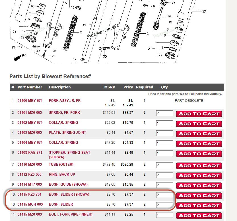

Looking to order some parts, and Partzilla has (2) "Bush, Slider" part numbers listed for item #10.  Did a google, and both parts come up as valid - in that someone on ebay is selling both...  Grin
Any idea as to the difference?  Called my dealer, and they (surprisingly) have something in stock  Shocked  They have the 51415-MCH-003 (non Showa?).
BUT: She also indicated that both sets of numbers (Showa and non Showa) are apparently not valid.
I guess I could take the forks off, then take apart, then take the existing "Bush, Slider" parts down to the counter, and see if they match the ones she has.  If a match, I'm good.  If not, then order the "other" version... Roll Eyes  Why does this have to be such a pita???  tickedoff

Just took a quick look at HDL and they show the 54145-MCH-003  twice and don't differentiate if one of them is SHOWA or not.   crazy2   Honda parts numbering can get confusing, but I would work with the above number. FWIW  Good luck!  Roll Eyes

I keep a set of these on hand and I'm showing the part id as 51415-MCH-003.  Their Genuine Honda parts, made in Japan.
Honda owns SHOWA from what I've heard, so maybe their just adding brand id to the new number.

As we seem to have two votes for the MCH 003, and that's the version the dealer has in stock, I'll go with the consensus.  But when I get it apart, if they're different, I'm not gonna be happy...  coolsmiley

My 1999 Interstate front fork tubes are stickered Showa whereas my 2000 Standard are not. The stickers are on the inside of the outer down tube right next to the fender. Perhaps there is a difference between the two?
