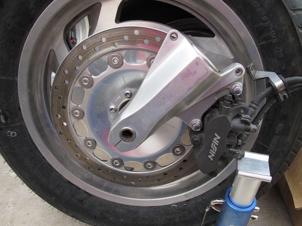

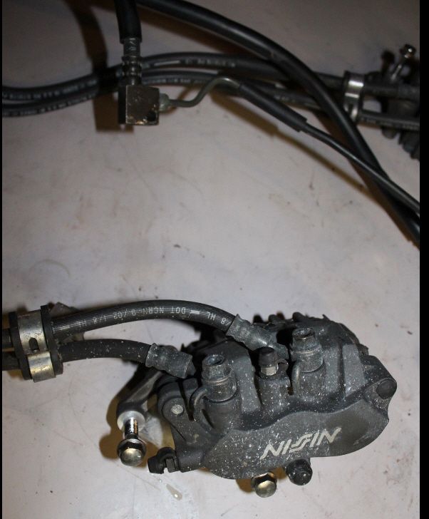

Well, decided I needed another project...
For $100 delivered just got a pair of VTX1800 6 pot calipers, hoses and MC.  Killer deal!
Just got home and opened the box, and the bolt pattern is identical to the Valk.  And I know the rotors are the same size as well.  Two big problems solved.  Looked at them a bit, and thought... hm, that looks familiar.  Went over to the 2002 ST1100 ABS and compared calipers... the fricken calipers are the same! This is gonna be interesting.  cooldude
May take me a couple weeks to get on this, as I have fresh paint coming, and there is a sidecar show in a couple weekends.  But from what I see right now, the VTX1800 6 pot brakes and the GL1500 linked rear master should be a not to difficult swap.  Stay tuned... Cool

I looked the VTX front calipers as a upgrade awhile back but
changed my mind when I seen they were linked.
Can you put them on with out linking them?
cheers...

Brian - I think it would, but you would need a "1 hose to 2 Banjos" fitting.  And from what my custom brake hose guy here in Tucson tells me, every hose he does is pressure tested to 2500 psi.
I took a bit of time yesterday and pulled off the right side caliper and tried to fit the VTX 3 pot.  Close, but no cigar  Sad.  Will take some welding and fab.  While the caliper adapter bolts are the same size/spacing on the VTX and the Valk, the adapter on the VTX puts the caliper in a slightly different spot on the Valk.  It is the caliper-to-adapter bolts spacing that is different, because the bosses cast into the VTX caliper are in different locations than the Valk.
In essence, each hole on the adapter is off by about 1/4" - where the partially screwed in chrome bolt is protruding on my pic below.  I made up a pattern, and will fab a couple pieces of 6061 to weld onto the adapter, and then mill them flat.  The part also contains one side of the mount for the pads, and the pins that the caliper rides on; so it is easier to alter the existing mount than to machine a new one.
This is the type of project where a 3D scanner mated to a CNC Mill would make short work of this.
Alas....
