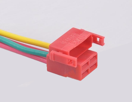

Okay Chief, perform the following tasks.
1.   Carefully pull the right sidecover.
2.   Look for a black boot with a bunch of wire going in and out of it.
3.   Pull the boot back and take a good look to see that the item that looks like the above picture, hopefully does not look like this.
4.   If it does, you need to replace this melted part.   Using older gold wing parts or like some of the guys have done on this site.      Do a search and read all of the links that come up.
Here are the parts I used.   Have to move the big red wire to match the red on on the Valkyrie.
Let us know what ya find.
« Last Edit: March 28, 2015, 03:26:59 PM by R J » Logged

« Reply #26 on: March 28, 2015, 03:52:19 PM »
Expanding on what RJ has just shown, I can speak from lots of Goldwing experience that the high current passing through that connector (I believe it is the stator connector as with the Goldwing) has caused lots of misery in the GL1200 world.    Recommended practice there is to eliminate that connector and hard solder the connections.  Those connector contacts develop resistance over time and then do not handle high current well.  The result is obvious in the photos above.  The plastic connector body is melted, but more importantly, the contacts have been scorched creating an even higher resistance condition.   This makes a bad situation even worse.
...made me go out and see what kind of shape mine was in.
And zzed28 - you did not hurt your Valkyrie by jumping it off a running truck.
« Last Edit: March 28, 2015, 04:10:49 PM by desertrefugee » Logged

« Reply #28 on: March 28, 2015, 04:21:35 PM »
Driving lights without a relay, jump starting the bike with the jumper car RUNING also cases this.
I'm afraid we might just have to respectfully agree to disagree on this one.  That connector carries the full  current drawn by the entire motorcycle through one wire.  Depending on accessories - or even factory - that can be a lot of current.  Especially if the contacts are degraded.  They will get hot.  Over time it's cumulative.

NO, it will not start when jumped with the truck, the voltage stays in the elevens though when I jump it from the truck. I know in the Yami venture world,,, the cdi would fire down to something in ten volts.  I would just love to buy a new batt and be done with this, but I think the connector is the problem now, I think that is what explains all the bizarre stuff thats going on.  If all the voltage is running the bike thru that one wire,,, any kind of tarnish will put that into a problem.. I did find my cans of DeOxIt today while looking for some dielectric grease, so if this is what it is ,,,,the DeOxIt is sposed to be about the best. And I can sure solder, but is solder ok with that thing, kuzz the one reply says to find another connector.
I had another post to ad,, re looking into that connector, dont know if I can that done tonight but tomorrow for sure.  Or at least take a gander at it.  So is the final solution for tht connection, to find some new parts, or to hard solder all the connections??"?  If solder will do it, I am good, if I gots to find parts, not so good.  The dealers here are not so hot at all.  Pretty much stuck with Stevens Midland , or even  worse mount pleasant.
Its good that its still cool out and I dont mind working on that thing.  And yes, it will be good when this op gets his valk going.

I don't know if you ever mentioned where you were reading the 12V battery voltage, but if it's directly off the battery and still dropping dramatically when trying to start, then the connector is not likely to be the cause - it's the starter current drain that's dropping the voltage so dramatically during cranking.  But, if that connector is not passing voltage efficiently, it won't help that the control box isn't getting a good 12V.
Try reading the 12V at that feed to the rest of the bike.  The fat red wire on the suspect connector.  Take the reading on the side opposite the alternator.   Folks here have said that the Valk likes a solid 12V to the box.  Most bikes do - Yamaha in particular.
Do you have spark on the plugs?  Pull one, connect it, ground it, crank it over and look for fire.  Fat blue = good.  Fat red = workable.  Feeble red = low primary voltage.   None = Report back.

These things are available on the Internet, $6.

« Reply #34 on: March 28, 2015, 07:04:36 PM »
I am reading the voltage directly off the battery terminals.
Ok, I will read it at the fat red wire and see what shows.
I do have spark on the number six plug today, when the bike was being cranked with just the reg bike battery and the charger on.  That is the same as with the last two days,,,its only the really rainy day when there was no spark at number six. I have not pulled the rest of the wires to check them.  Number six is fat blue, yeaaaa.  I know that this spark is also suspect, since there is NO compression when the plug is grounded on the engine, like there is in the chamber.
I am going to do the other stuff tomorrow ,, that is described above.  Check that connector and the voltage at the big red wire.  If all looks good, I am gonna pull the tank and make sure that I have fuel running. If that works, I am gonna pull all the plugs and inspect, and prolly replace them.  I will obviously fix the connector or wires if that is suspect.  I have another battery that I may be able to put in it, I have to check it first.
