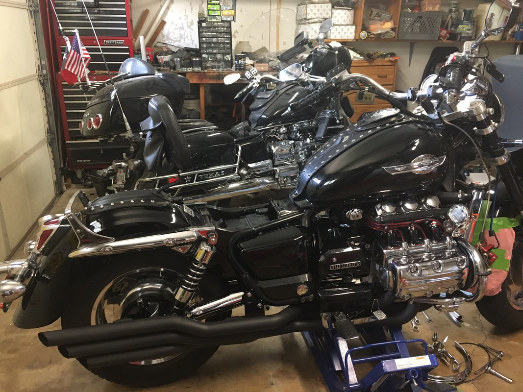

After eight months of telling myself I need to sell the standard, all the while my girls are all telling me I need to keep it, I gave up.  I started putting all of the accessories I removed months ago back on, hopefully she'll be better than ever.

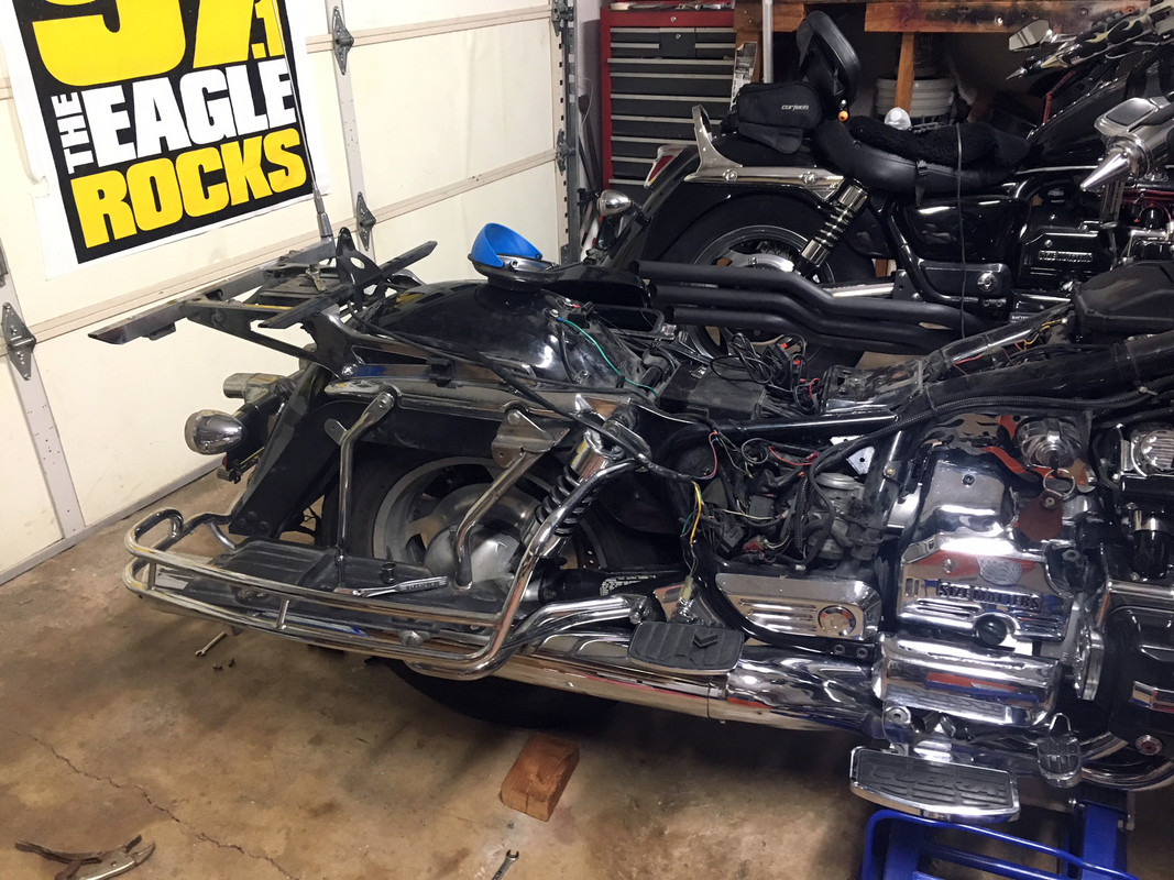

Not just today, but this weekend;
(Re)installed black powder-coated intakes
Black powder-coated carb covers
Black powder-coated tranny covers
Spark plug valances
Tank bib
Clint fuel cover
Chrome drive shaft cover
Batwing fairing
LRS recurve windshield (new)
Car horn
Hondaline fork wings
Bullet driving lights wired through a relay
Creepy mirrors
Three switch power block for the LEDs
Gobs of LEDs
Black levers with black and red fringe
Stiletto bar ends with red, white and blue accent rings
Lots of taillights
Luckily, I had a second tail light assembly and all I had to do was switch them and run a few extra wires.  I had also added a waterproof plug on the housing making it easy to power the lite license plate frame.
Maybe more, this is all I can remember right now...

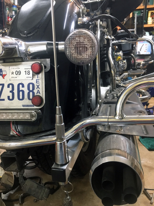

Installed the Hard Krome 6x6 pipes.
I also wanted to replace the 55w halogen bulbs in my Show Chrome Bullet lights with LEDs.  The ones I bought from Home Depot were worthless for anything other than a daytime running light; they must have had at least a 120° spread because I could see a cut-off line across my garage ceiling and they were much too warm of a color.
I bought, and am impressed with, these - https://www.superbrightleds.com/moreinfo/rv-retrofit-dining-light/mr16-led-bulb-1-cob-led-spotlight-bi-pin-bulb/3286/
685 lumens, 40° spot, 4800K white, still not as bright as the 55w halogens but close enough to make it worth the energy savings.

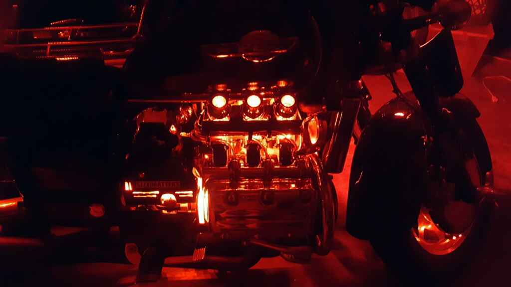

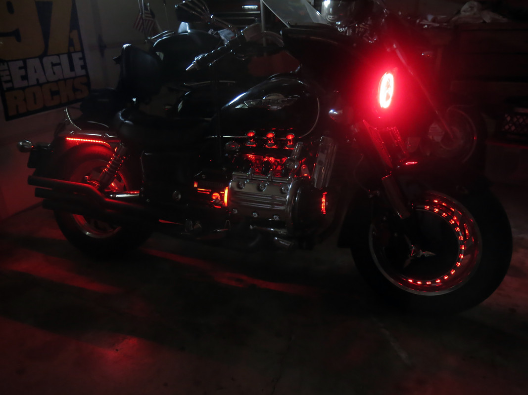

Not just today, but finished my LED project (for now).  I also installed my Josh headlight bracket and DayMaker headlight with red halo.
Including the cam cover inserts I bought from F6Banger a few years ago.  I bought the set as blanks since he doesn't make the sets anymore and made a fire effect.
https://drive.google.com/file/d/0B7_RBEvpEDlPbXNYOVRHU0xtRGc/view?usp=sharing

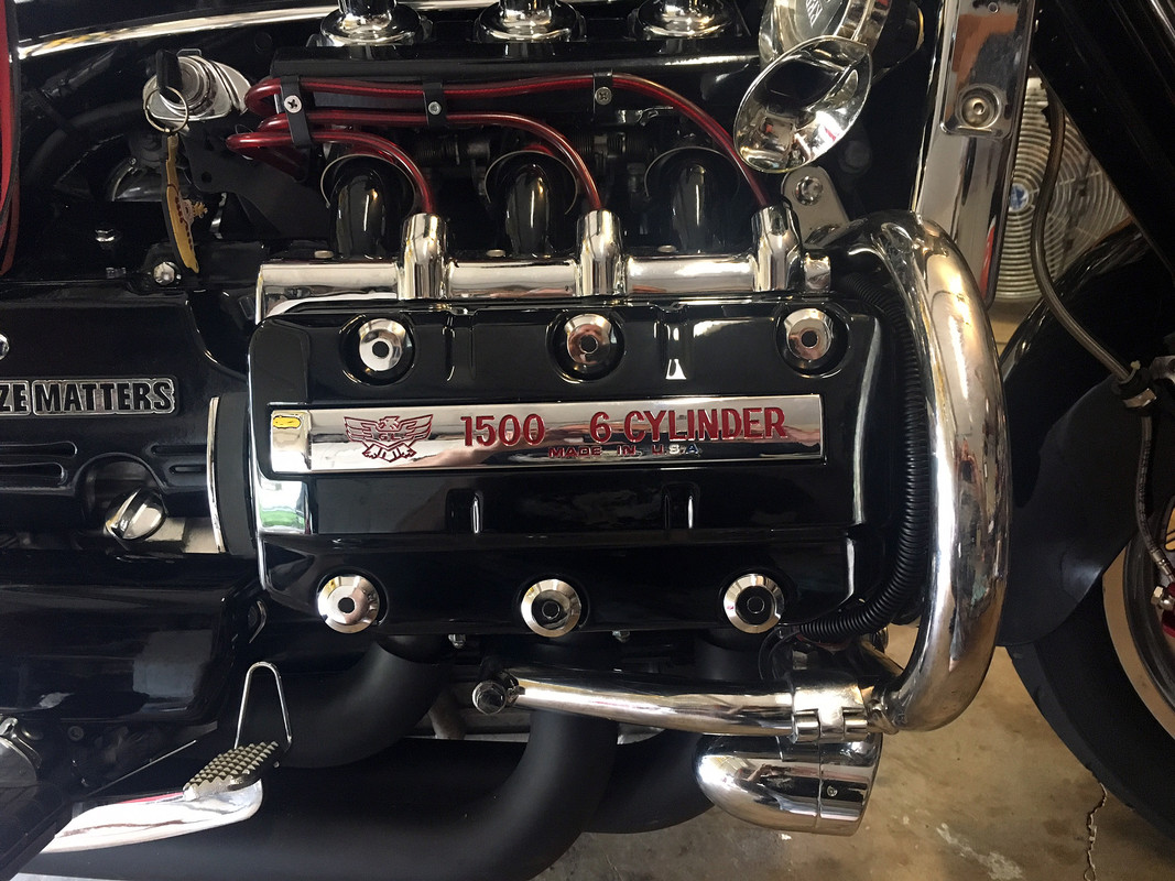

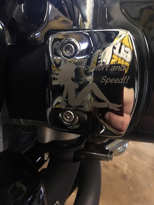

Swapped the chrome valve covers for black ones and added some bare nekkid ladies.
Ooh LA LA!

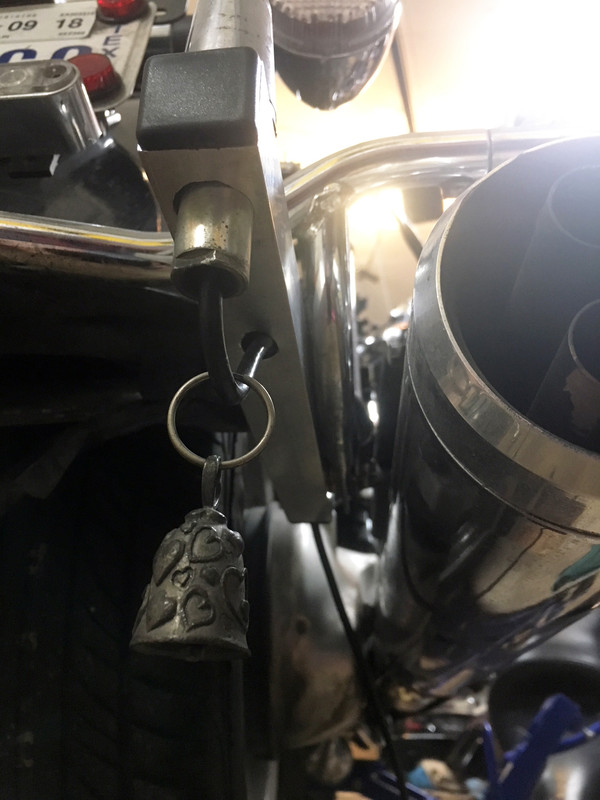

Hooked up a remote to my horn. Next will be a motion angle censer for when parked, that will set off horn when motorcycle is disturbed.

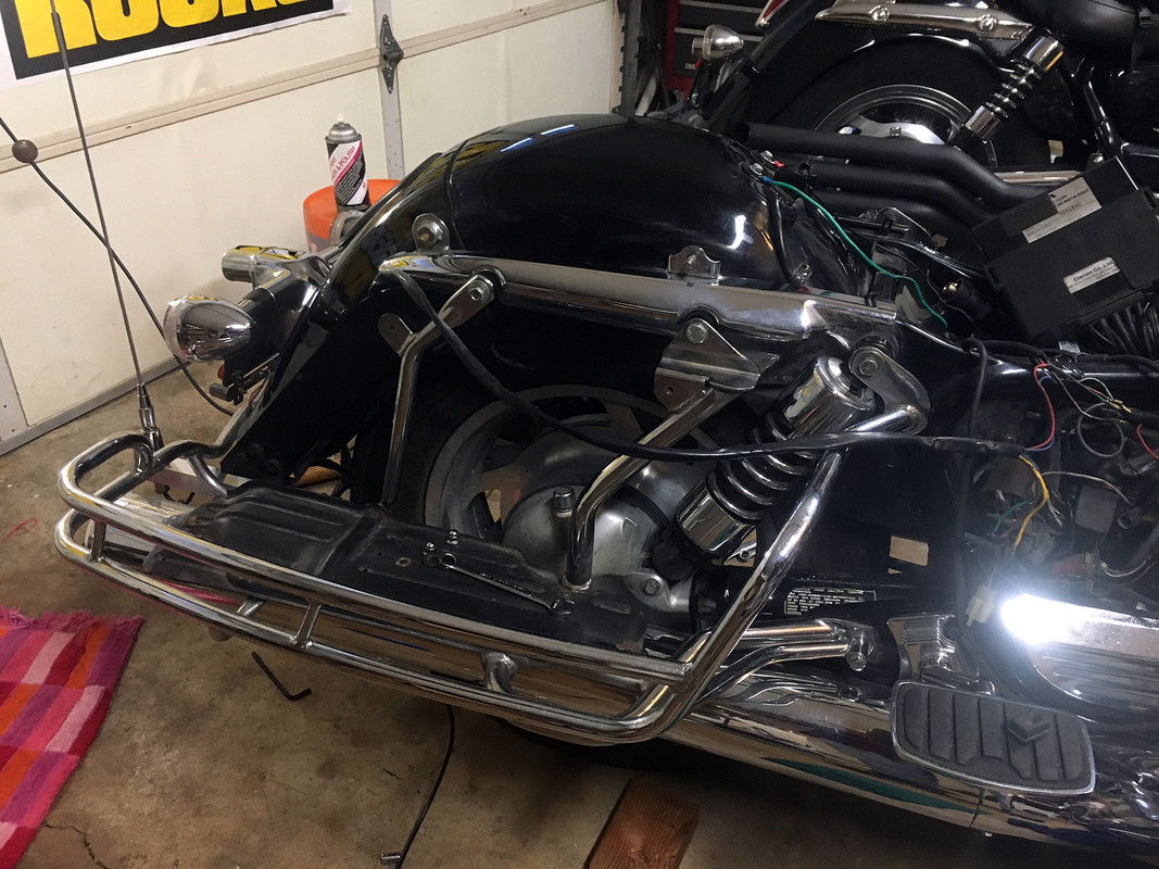

I pulled the saddlebag rails off the IS and they were sold.
I sold a local member the Utopia backrest for Standard / Tourer, and pulled the one off the IS that the seat had been impaled by.  It's going on the market next.
I also pulled the trunk rack, swingarm covers, engine hanger covers, kury engine covers (not spark plug covers), off the IS.  I also pulled the tank & trunk bibs (dirty, but should clean up OK), and bra (ratty, but could make a good pattern).  All of that is going on the market.

« Reply #311 on: March 03, 2018, 09:22:43 PM »
Took the trunk off of my IS

Houdini
Posts: 1975
VRCC #28458 - VRCCDS#144
Allen, TX
« Reply #313 on: March 04, 2018, 05:23:22 PM »
Stripped off more stuff
Mounted my radio antenna using the Chauffer Mod
I modded the mod and ran the cable on the inside of the tube.

« Reply #314 on: March 04, 2018, 05:59:43 PM »
Houdini, just a word on the antenna.
I do not have an intestate (or other long) whip back there on my supervalk, but my Firestick CB antenna (maybe 20-24")  is mounted back there higher on the top bag rail, farther out.  It doesn't happen often, but sometimes at high speed with bumps and crosswinds thrown in, mine will get moving back and forth or around in circles, and has hit the saddlebag lid, and my tail light lens (std on interstate fender knockout) hard enough to to mark the paint and the lens.  The first pic that shows it leaning back a bit, is a good idea, and maybe it's stiff enough.  Mine was mounted straight up (on a really stiff spring), and I had to lean it back where it won't hit things no matter how much it flies around, in the right conditions.
It didn't happen often, but when it started knocking on the bike the first time, I thought something bad was happening in the drive train or a wheel bearing.  Thump, whack, and off the next exit I went.  It was a complete mystery, until the first time I looked back and saw it whacking my bag lid.  WTF?
Maybe it can't happen with that whip.  Just a heads up.
