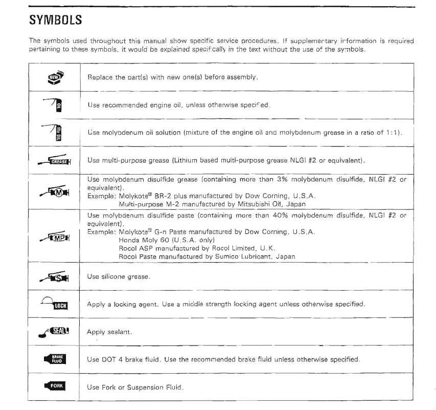

I can't speak to the risk of damage, but here's the relevant info:
« Reply #8 on: May 08, 2015, 10:33:41 AM »
Thank you, I should be paying closer attention. Angry
