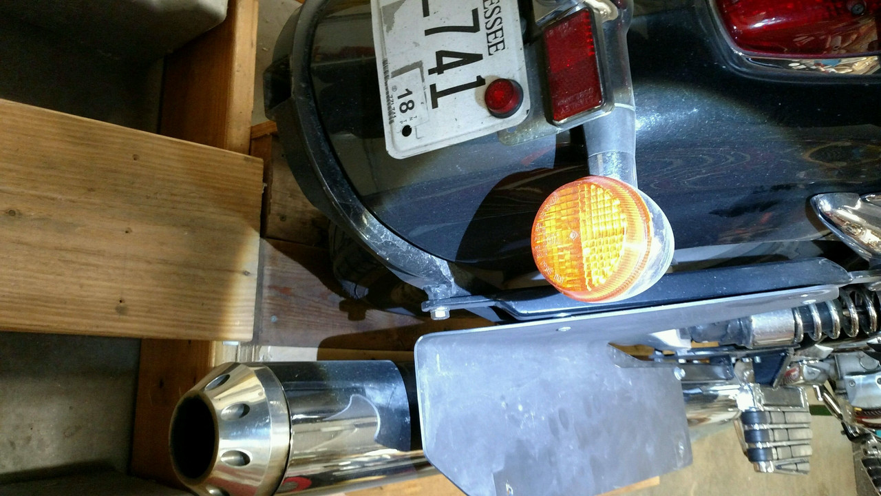

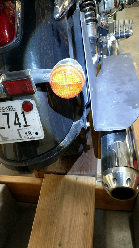

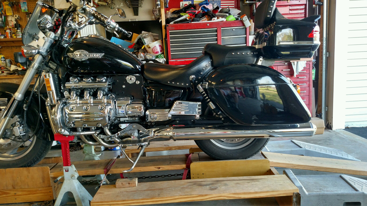

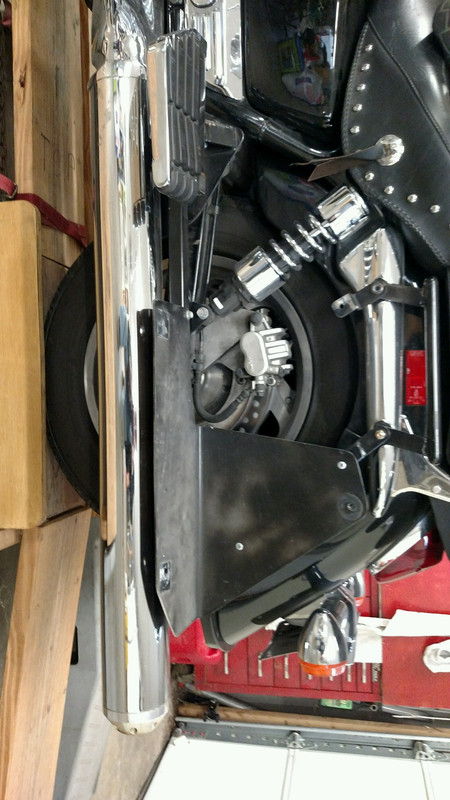

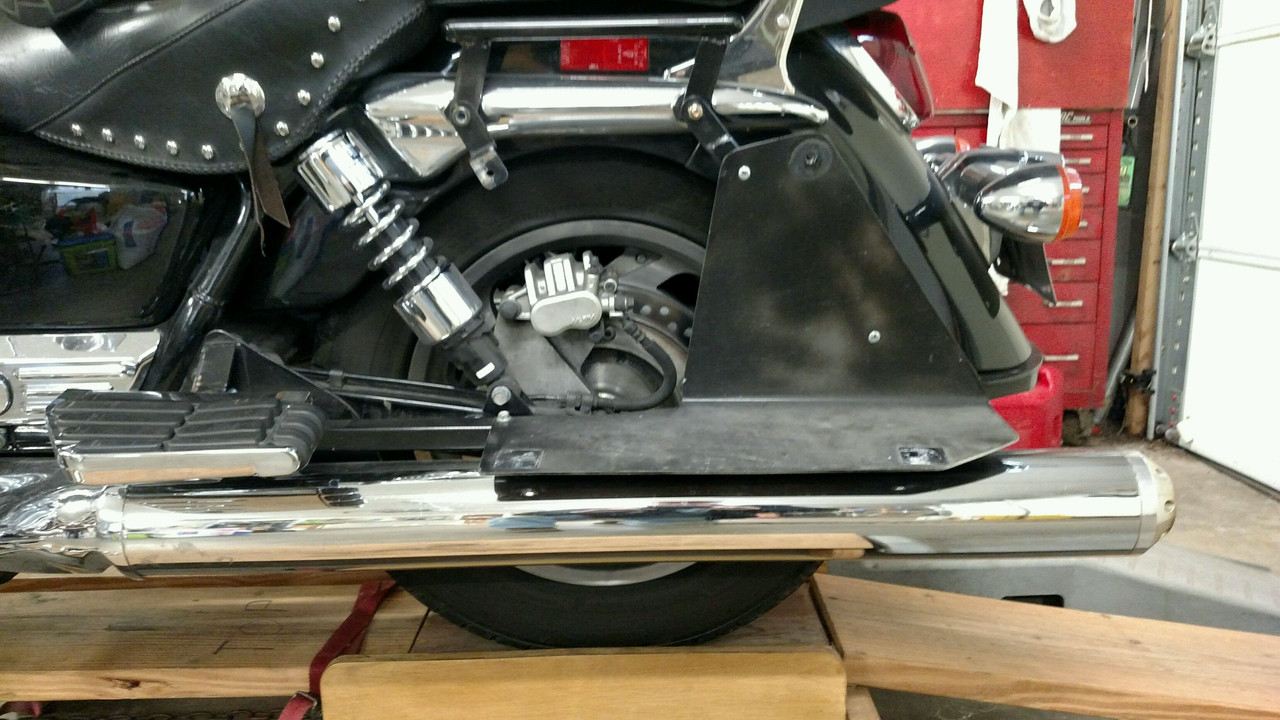

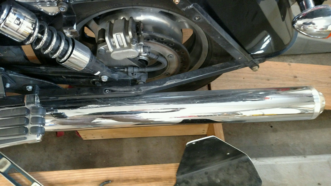

« Reply #23 on: December 25, 2019, 12:07:44 PM »
I am a DIYer and always looking for the cheap way to what I want.  What follows is a photo story of my jumbo strongs and my combination trailer hitch and bag mounting system.
And
And
And
And
And
And the metal tray the bag sits on and is bolted to is 1/8 aluminum that also serves as a heat shield for the bags.  One bolt goes through that plate and into the bottom of the bag,  2 bolts through the back of the bag and that plate towards the rear of the bike and another bolt through the back of the bag and the steel bracket at the front of the grab rail.  The bags are solid.
